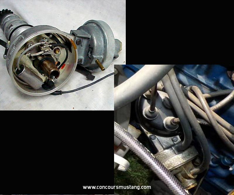

This topic has interested me for some time.
Let's say there are two units side by side that are visually identical e.g. same nipple style, same font style for marking, same stamped code e.g. A12, B12 etc. Is it only the removable internal pieces (i.e. washers, spacer and spring) that vary between say a unit for a six cylinder application versus an eight cylinder application?
No for these two applications they are shaped differently. For lack of a better description (looking straight down from the top) the V8 one attaches from approx 3-6 o'clock while the 6 cylinder attaches from 6 to 9 o'clock
I'll just post a picture
Both 68's (sorry was a bit warm to go out and get a NOS 6 cylinder out and take a picture) Upper left big bloc - lower right a 6 cylinder
Now back to the discussion leaving the 6 cylinders out :)

Ah now I see the difference between the units for eight cylinder versus six cylinder applications.
