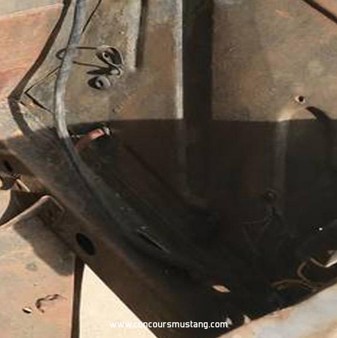

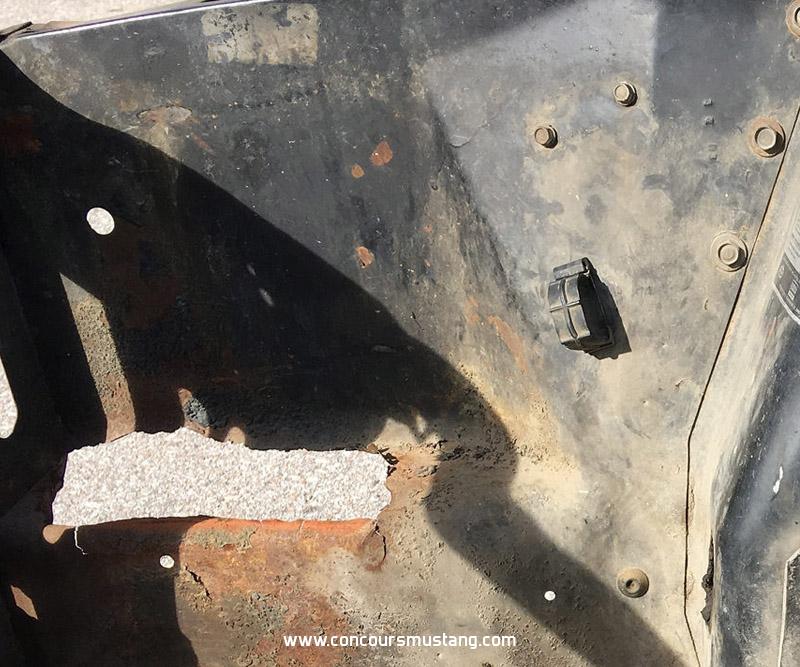

NOTE: Originally I posted a picture and description of the post and strap at the upper drivers side firewall for the flat retainer strap you posted a picture of. I posted the easiest picture I found but since the production date is so far from yours and I found others closer (strap was used differently) to your production period I reworded this post and opened a new thread to discuss the possible running change related to that retainer.
Richard, looked through the examples showing the use and location of the attaching pin the flat plastic straps were attached to and the method that were held  Since these same and similar loops were used at other plans and years needed to focus on just Dearborn and as close as possible to your VIN since that is what you provided. I came up with two. Of course the location of this loop and the post is difficult to find in pictures focused on other details or the general area so sorry I don't have allot of them to offer.
One from 8F17189x
This example appears to show that during the construction of this car they looped both ends to the anchor like the example above. 8F18222x
As for the location of the retainer holes for the wiring and washer hose Bob mentioned pictures will only possibly get you close but likely not exact and I agree but will post some pictures, as you requested in posts below

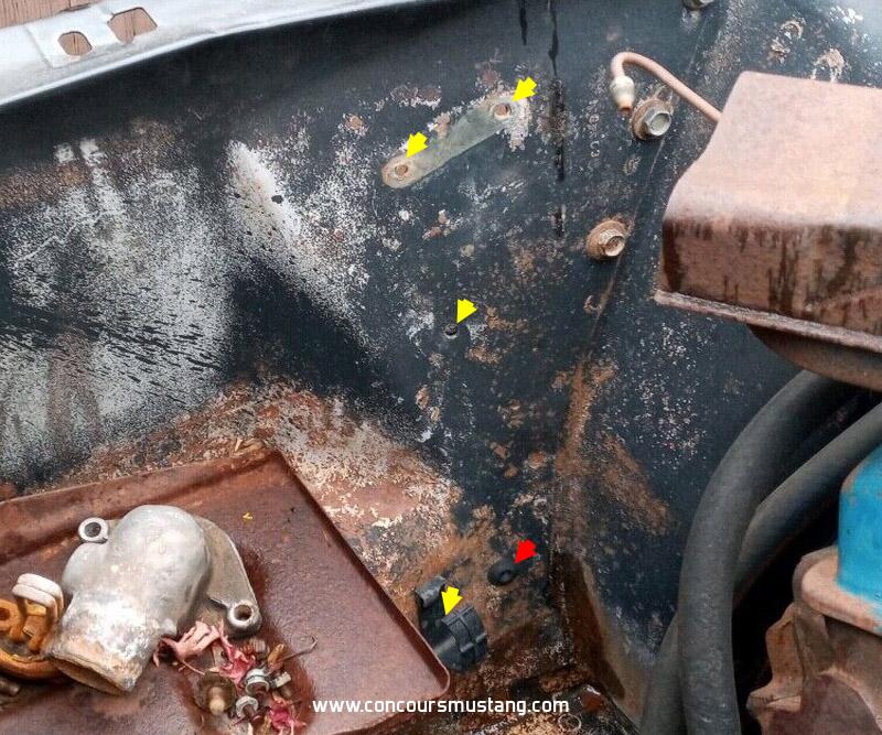

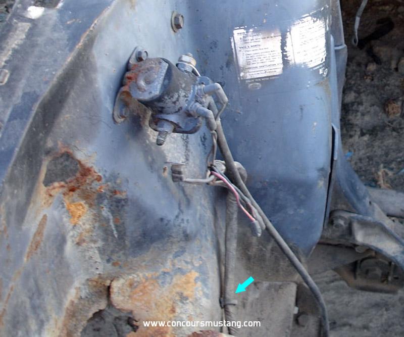

« Reply #3 on: September 08, 2023, 05:50:56 PM »
Drivers side forward inner fender. Highlighted on to try and help out
8F17189x
8F18xxxx
8F2022xx

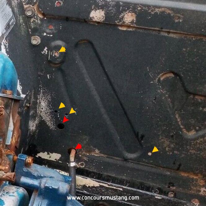

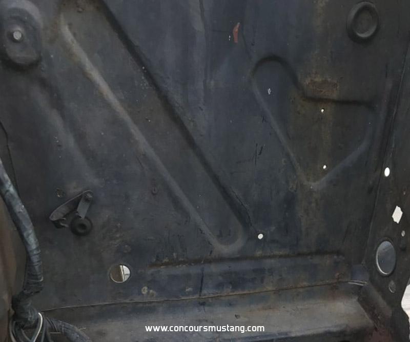

« Reply #4 on: September 08, 2023, 05:54:15 PM »
Passenger side forward inner fender panel
8F121xxx Interesting that it appears that on at least this car and maybe all early built cars Dearborn used the smaller wire loom retainer used in other areas rather than the big D retainer on that lower and possibly the upper holes shown in this picture. Something else to chase down  ::)
8F157xxx
8F168xxx
