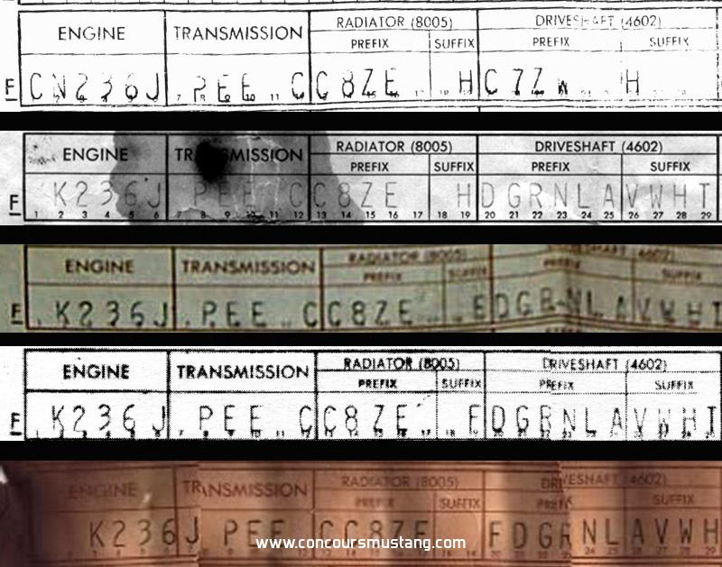

Split these off to their own thread since they are 68 examples. Including a close up of the section of a 68 C code built Mustangs with an automatic transmission  ;)
Interesting to not that they appears (well at least at San Jose - the example at the top of the page) they started out installing the same driveshaft as they used at the end of 67 C code automatic production. At least from the engineering code printed on the buildsheets to help guide them to the correct one for the application. Some where between Aug 67 and Decemeber production. Sorry didn't have any clear examples between these two approximated months. Had to use the projected/scheduled build date from the build sheets
Below are close up sections of buildsheets from both San Jose and NJ built cars ans their \approximated build dates (from top to bottom
25H - Aug 25th
31M-02A - Guesses based on VIN
05C - Mar 5th
21F - June 21st
Some of you may remember an earlier thread on the subject.  Might merge this one with that one in the near future

Adding information here from a May 68 built C code from Metuchen.  If I am reading the build sheet correctly it reads:
Dark Green, Lavender, White
Yes that would be the correct decoding.

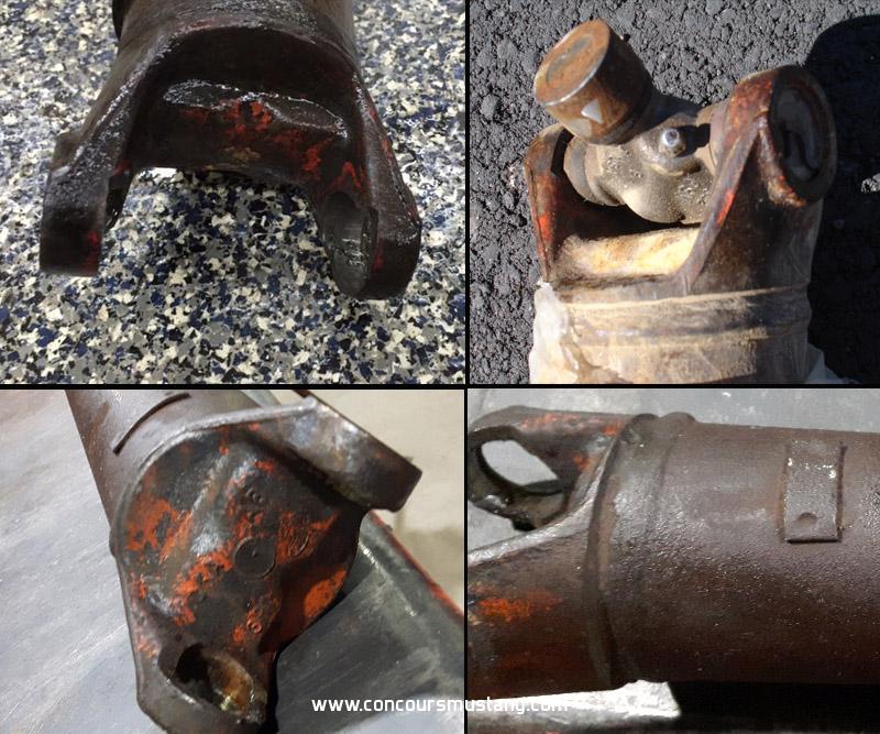

Both previous posts show a dark red color on the driveshaft yokes (front and rear) . I have not seen this before- can you tell me why you used that color?  I added small orange markings on the rear of my 1968 Mustang driveshaft (428 engine with a 9 inch axle) as I was told that Ford used the driveshaft color code at the rear to match that color on the axle yoke.
Never heard that and original examples that I've seen over the 40 plus years have not shown that. The color on the yokes helped the worker making the driveline identify the yoke size and type so if you have a different drive shaft with a different size yoke you would not have the orange coloring. Also when the yoke was welded to the tube it would burn the paint along the weld area. Haven't seen orange on small block drive shaft yokes
Some examples from 68 big block applications. Paint exposed (like the stripes) didn't hold up well to the elements and usage  ::)
According to Ford documents , a TSB, in late 65 production they painted indicators on the yokes so that the driveshaft when removed could be reinstalled back as it was originally. TSB # #416 dated Sept. 17, 1965 if anyone is interested

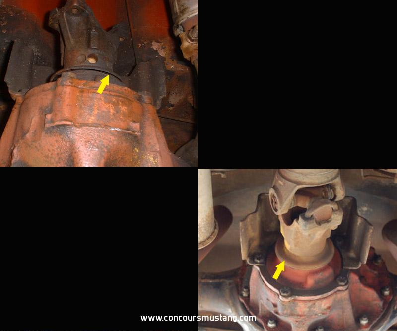

 lightwtjet - Is the car in the picture yours? It appears that the shield washer is missing between the yoke and the third member as sown in the original examples from 68 9 inch rearends below

Thanks for the pictures showing large amounts of orange paint on the rear of the driveshaft on big block applications. My driveshaft only had a small indication of orange left. That is my axle but is not the original axle- My car had a 4.30 ratio axle installed by Ford, and I found that ratio incompatible with driving to car shows. The axle I installed had a damaged yoke. I went to a known quality axle builder to purchase a new yoke. When the yoke  arrived it did not have a slinger(shield washer) much to my dismay. Something others can avoid possibly. I added the orange to the axle yoke as I have seen on two websites -links are below.
