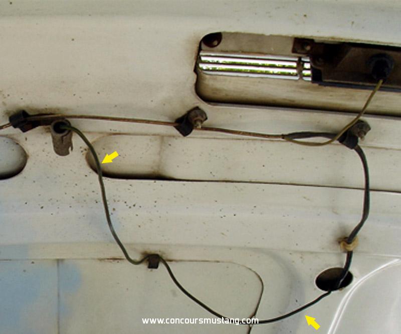

Looking at these and the NJ examples in a separate thread there was a single wire that ran from the light mounded in the center of the hood that traveled down to the bottom (once hood was open) where it exited and was retained with a small plastic retainer. It then traveled under the cowl to firewall pinch weld/lip to the solenoid where there was a inline fuse holder made of white or off white plastic. There are a number of those small thin sheetmetal retainers located in different spots or locations. These retainers of clips look to be the same that were used on 65-66 fastbacks in the trunk holding the wire for the passenger side rear interior light as it traveled across the trunk just below the rear window. Maybe different workers choose different spots when they did it. The wire and in some cases the clip is highlighted in some pictures with yellow arrows.
8R01S114xxx Only picture of this car is a poor one, up close at the base of the hood once opened

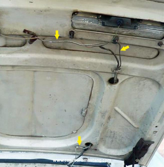

8R01J119xxx
In this one we can see where a past owner disconnected the wire at the fuse holder, wrapped it up and shoved it back in the lower hood hole. We can see that at least two of those small metal clips were used on the installation.

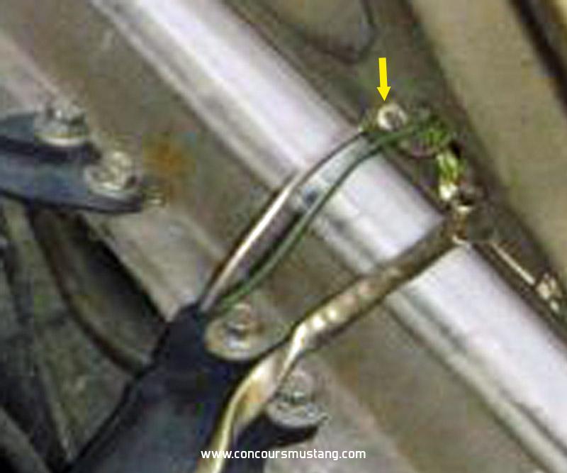

Same car as above 8R01J119xxx On this one we can again see one of those small metal retainers used for the underhood light.

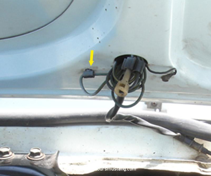

8R1404xxx

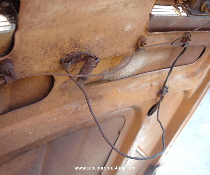

8R01J161xxx
