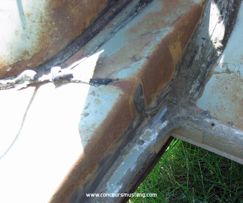

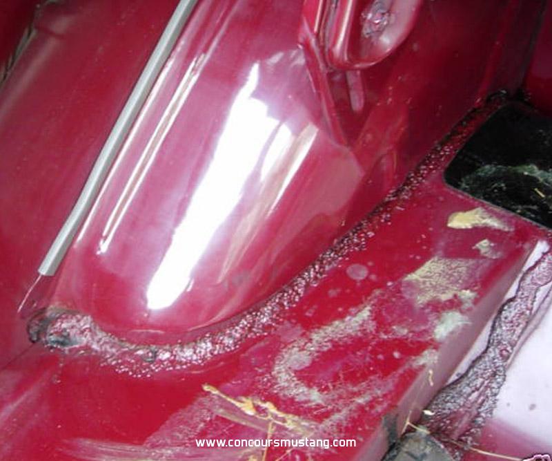

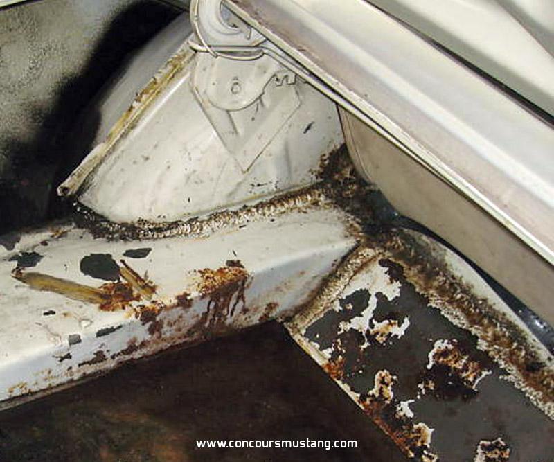

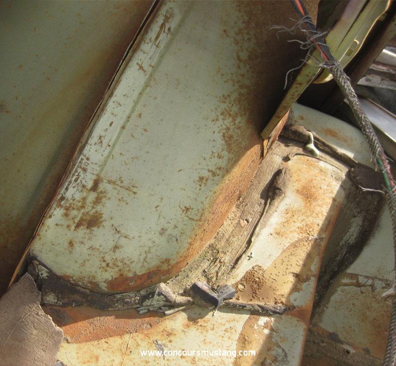

Of course on seams as you describe sound deadener was not used for the purpose of sealing these sorts of joints but guess your using that description to try and describe the final look you were going for.  Looking at your March date you included as your cars real build date, as my current understanding it was built right around the period where NJ changed product and application styles from the earlier chalk and spread with a solvent rag to a spray seam sealer that at the wheel well to floor sides as well as trunk side floors to forward trunk floor in the trunk.  As illustrated using unrestored cars below.
Here are some looks at the seam you identified  from 68 NJ cars. Just random since you didn't include when the car was assembled
8T115xxx Brushed/smeared not sprayed
8T155xxx
8T18
After the change in product and application method
8T194xxx
8T197xxx  Cars assigned VINs higher than 8T200000 were the subject of an earlier discussion and thread
Going to move to the 68 section since we have the details about early and late 68 NJ cars specifically
