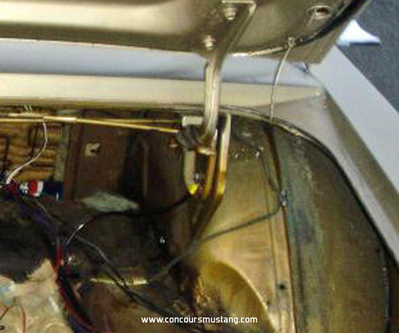

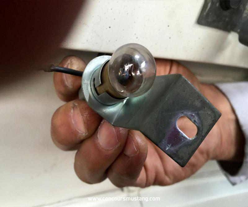

I looked thru some older posts but could not find a good photo.  Does anyone have anything to share that shows a 68 trunk light installed.  Looking how the wiring was routed and clipped.
Not a popular option so I only found a few random pictures. Of course lots of 68 Shelby pictures with them since that was standard but they used more wires (they had an additional ground wire) , and all the connections were done at AO Smith
These all happen to be San Jose 68 examples

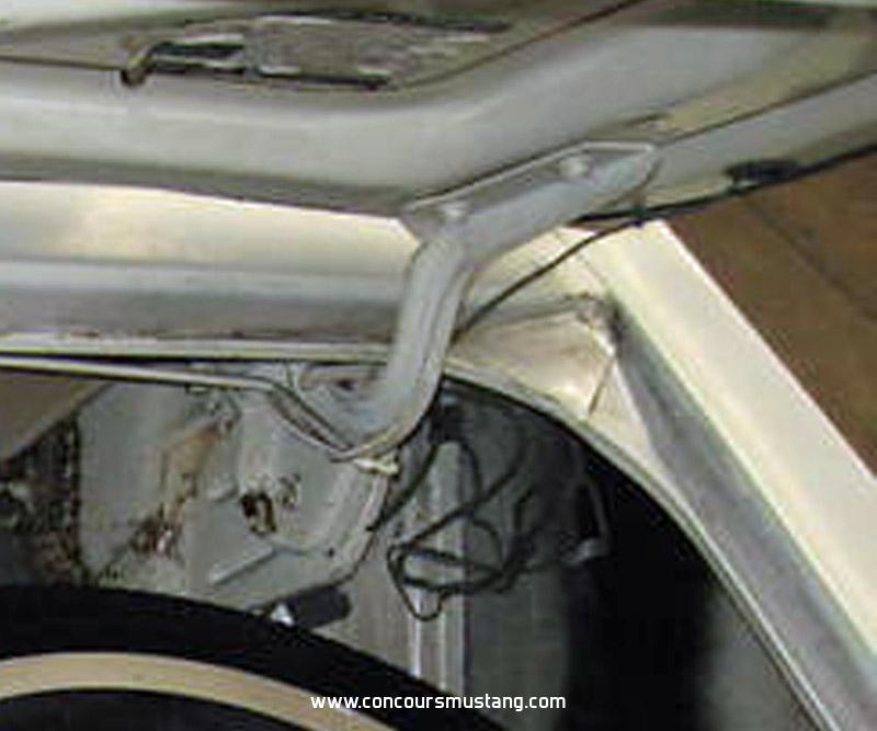

This one is painted because the car in areas was repainted. Notice that the trunk weatherstrip has paint on it also as well as the black plastic wire grommet on the trunk lid
8R01S114xxx

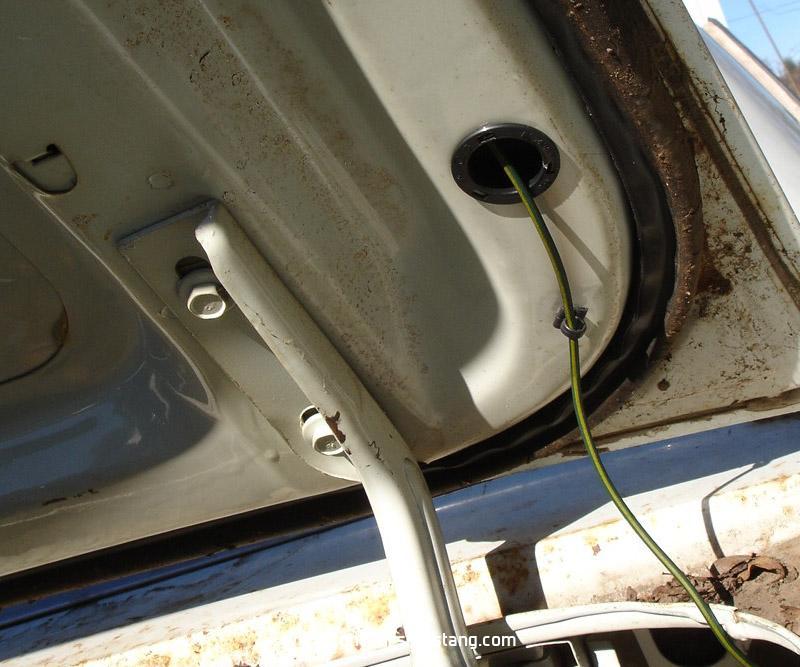

This ones wire travels towards the outer wheel well edge where it meets the quarter panel like we find on 68 Shelbys

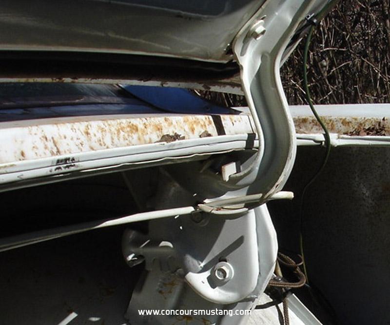

Didn't post originally since they don't show much but maybe as discussion continues or more are added maybe there will be something to will help in the following
8R01J1614xxx

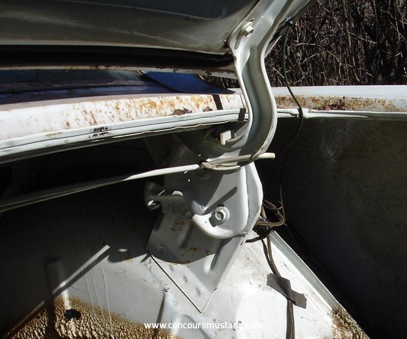

8T03C194xxx Not great picture of details but maybe it while have some value
