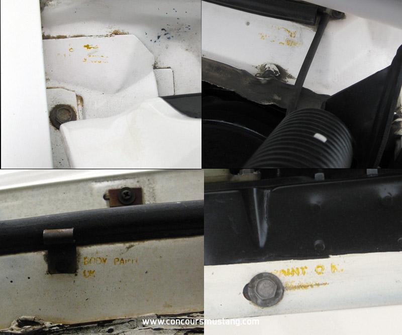

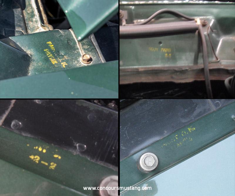

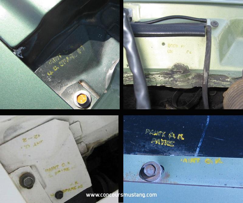

From examples I have in one of my files from cars scheduled for May 68 at NJ I've got the following (Likely have more in picture form)
PAINT O.K.       MARTZ                On the PS transition panel
BODY PAINT       O.K. 34              On DS Cowl
PAINT O.K.       #2 ?2                On PS Fender
PAINT O.K.       Q. C. SPARE #3   On the PS transition panel
BODY PAINT       O.K.  2?              On DS Cowl
PAINT O.K.       #2.-2                  On PS Fender
PAINT O.K.       MARTZ                On cowl
PAINT OK              VENTRIGLIA         On PS Cowl
PAINT OK              KERWIN               On DS Fender
Thought it might be helpful to see a series of pictures of the Paint OK and the Body Paint stamps from a single car in a group to get a better feel and understanding so here are two. Both are 68 Shelby's so they would lack the hood stamp applied to the bottom side of the metal hoods on Mustangs  Both are in the 8T205xxx range. If it helps pictures are arranged as you would see them when standing at the front of the car looking rearward. Passenger side on left drivers side on right. Hope this helps

First thought I would post some examples from through-out the production year.
For a Mustang the location and area for the hood stamp is shown in that earlier picture. Mentioning this since allot of the markings we find today are on Shelby's so they didn't have that marking since the hoods for them were not installed at Ford.  For specifically the May 68 period and around that time I added some of those to the reply above.

So we can assume the hood stamp and the fender stamp is the same inspector and the body paint on the cowl area is a different inspector.  Thats what I assume.
Has anyone seen stamps in or around the trunk area or on the trunk lid for the NJ built cars?
Jeff...from your examples this is probably the most interesting one.  Never seen one like that.
2023-10-29_22-47-33 by Marcus Anghel, on Flickr
Ive also seen examples where the paint stamp on the fender looks like it was clearly stamped before there was any fender bolt installed.  You have one example shown that you posted.

Seems that some Metuchen inspectors wanted to make sure you could read the stamping or someone wanted them clear so they could hold some one responsible. Have one 69 example where the inspector stamped a location three times all at different angles within about 6" of each other like he wasn't happy or trying to make a point or send a message to whom ever might be checking this sort of things. Workers were not always happy campers
Will check but of course that would support/suggest that the individual parts were inspected by another inspector, than the one doing the unibody, over near where the parts were painted in the plant like San Jose did through the years. Haven't sat down and laid the examples I have so that we could compare, on cars with multiple original inspector stamps still legible to see if they fit the same pattern as San Jose.  Maybe someone else has done that
