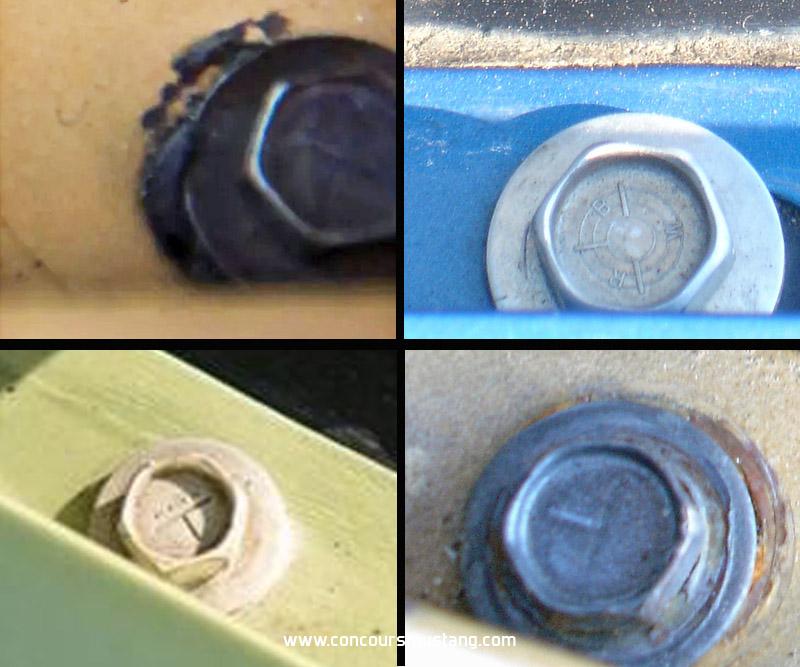

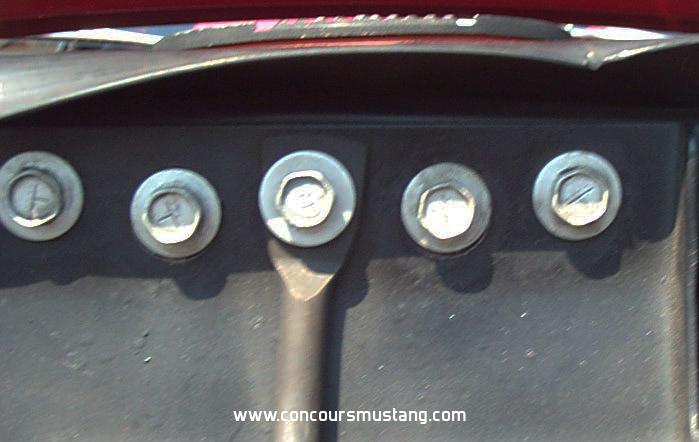

First want to thank dkknab for offering what he had found
Unfortunately not as many people taking close up pictures of hardware/head markings as we have for other years and plants. Here is what can offer
For fender bolts I must say in general 68 NJ cars appears to have allot of different suppliers for their fender attachment making patterns shorter or more difficult. Below are a group of examples from 8T1864-8T19322xx-8T1992xx-8T1996xx. Like often happens we don't have real build dates for each so some may be built a week or two before or after your car or others with VINs starting with 8T20xxxx. Some of the later 8T20xxx start turning up flag head markings mixed with others
Only other I was able to find a picture of was the picture below from 8T1924xx
