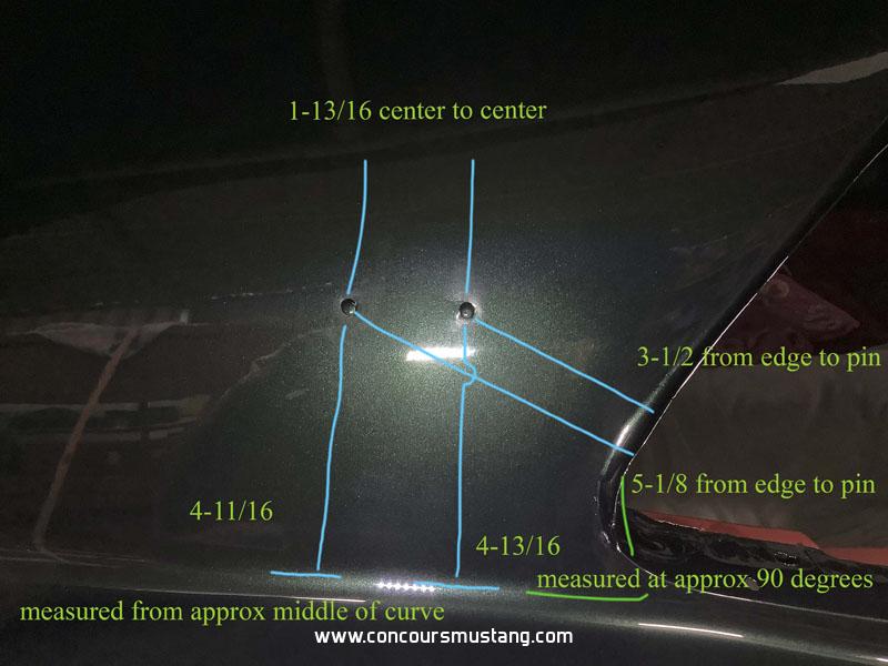

My '69 had the running horse emblems removed when I purchased the car. I'm having full quarters installed and my body guy has the correct studs to add back on. Does anyone have the proper location measurements for these?

I can measure for you in a few days time if you haven't had a reply before then

I can only measure the right hand side, hope this helps
