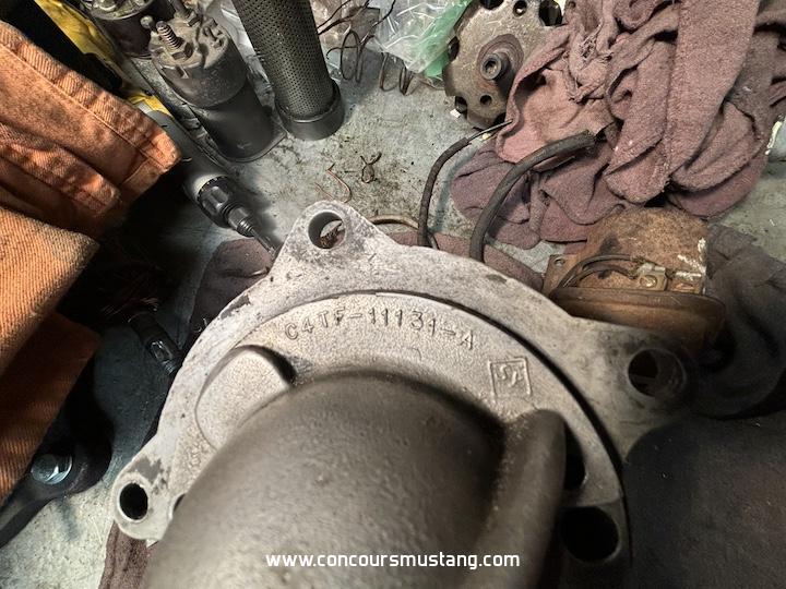

Just checking to see if the starter body is correct for my car and which nose would be correct or not. Would it decode as 1968, Sept 23, not sure about the part number. Would those noses be first gen 64 & 65?
  The center barrel case is the same 65-70 however the pictured case is stamped for a 1969 production car given the date code and a 289/302 automatic given the C7AF 110001 B engineering number. The nose cone is one of the most generic since it was used on a number applications over a number of years with only minor differences between different engineering numbers. The common denominator is that they will all interchange with each other and the nuance differences are on the inside of the nose cone when mounted. At least for the ones you posted pictures of.

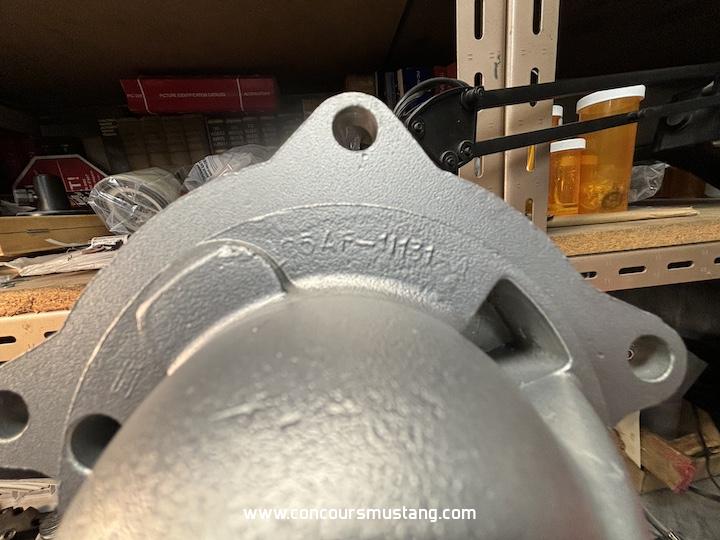

For what it's worth,  here's a picture before I painted the barrel of my starter,  a 289 AT car, as Bob mentions.
Thanks Bob that is great information. Since I am getting the starter rebuilt, I will continue down that path and add a different starter to the long list of stuff I need to swap out at a later date. The goal is to get the car running and proceed forward and make the swap outs as I find suitable parts. If I wait to get every part I need to put the car together I  may not finish this car in this lifetime lol. Interestingly the guy rebuilding the starter told me the case number was not correct for my application as soon as he saw it. Should the case have an A or C stamp for my car. I want to make sure that I get the right case. Thanks
C7AF-A would be for the 390 .
Ok great thanks, I think that is what the guys who is working on my starter said. How common are they to come across?
Re: 68 SJ 390 Starter Motor & Solenoid
« Reply #40 on: March 26, 2024, 11:57:48 PM »
Making a BB starter out of parts is easy . Finding a metal stamped C7AF-A case is relatively hard given there were so few BB vs. SB .If you want one a certain date code multiple how hard it is find by 10 IMO  ;) . Of course you can get luckey.
