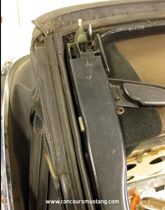

The canvas type material is what holds the top frame bows to the correct spacing before the top goes on.  Many aftermarket ones in the past were smooth cloth material, whereas the original was a thicker textured, like canvas material.  There are 4 pieces total, 2 long on each side and the quarter pads.
Re: Convertible Top Pads
« Reply #2 on: April 11, 2024, 08:14:15 PM »
To add to the conversation and for others in the future

Thank you. this is very helpful. I checked my top. Yes, I do have these pads, but they are the same material as the top. they are not as coarse as the material shown in the second photo. So, my question is: How are these attached, and can I slip out the ones I have and slip in a more correct material? Or does the whole top need to come off and start over? Thans again and for your quick response.
