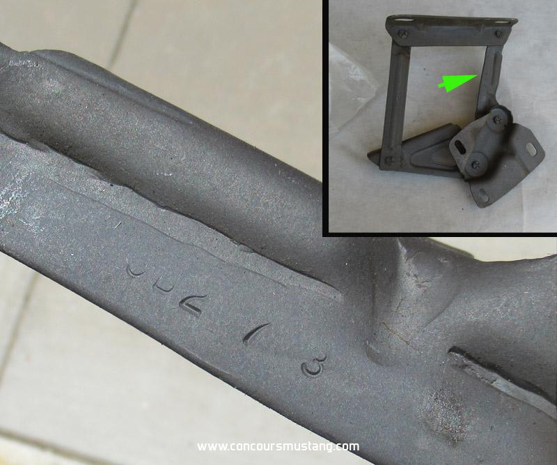

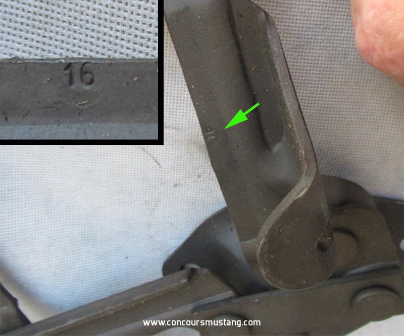

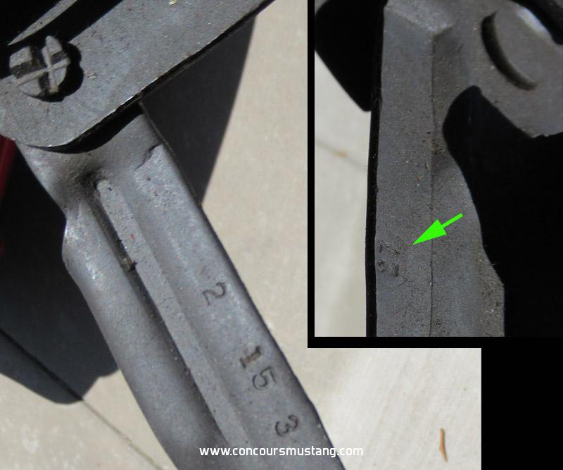

Re: San Jose hood hinge date code
« Reply #8 on: June 20, 2024, 05:54:00 PM »
Reporting back
Believe the hinges to be original to the car. Have know it since approx 1973 and dates are very close to other panel dates that make up the uni-body of the car. Believe the two digit numbers identified the stamping machine at the stamping plant so that if there was a problem discovered they would not have to toss all of the hinges out from that day just the ones that were formed in a specific machine
Driver side OB2 7 3
Driver side press number 16
Passenger side  No "OB" or other prefix 2 15 3 and press number 27
Prefixes or lack of them may have helped identify multiple suppliers. Might be outside sub contractors or multiple Ford owned stamping plants. Having multiple was a very typical practice for Ford since he hated the idea(there were big problems with this in the 20s) of one company or plant being able to hold up the entire operation
