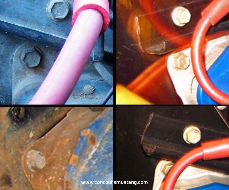

Here are some pictures of original mounting screws for the voltage regulator. Appears no star washers under the head of the screw on any of these. Original finish of zinc dichromate
