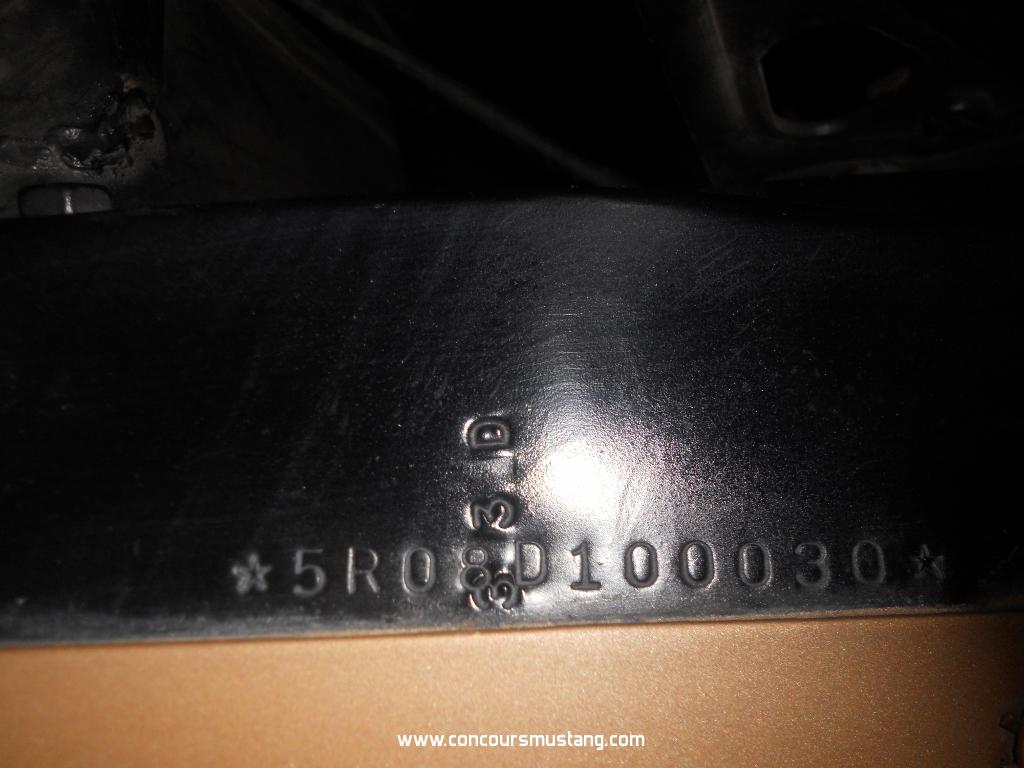

So now on to the question. What is this date stamp across the second fender vin stamping.

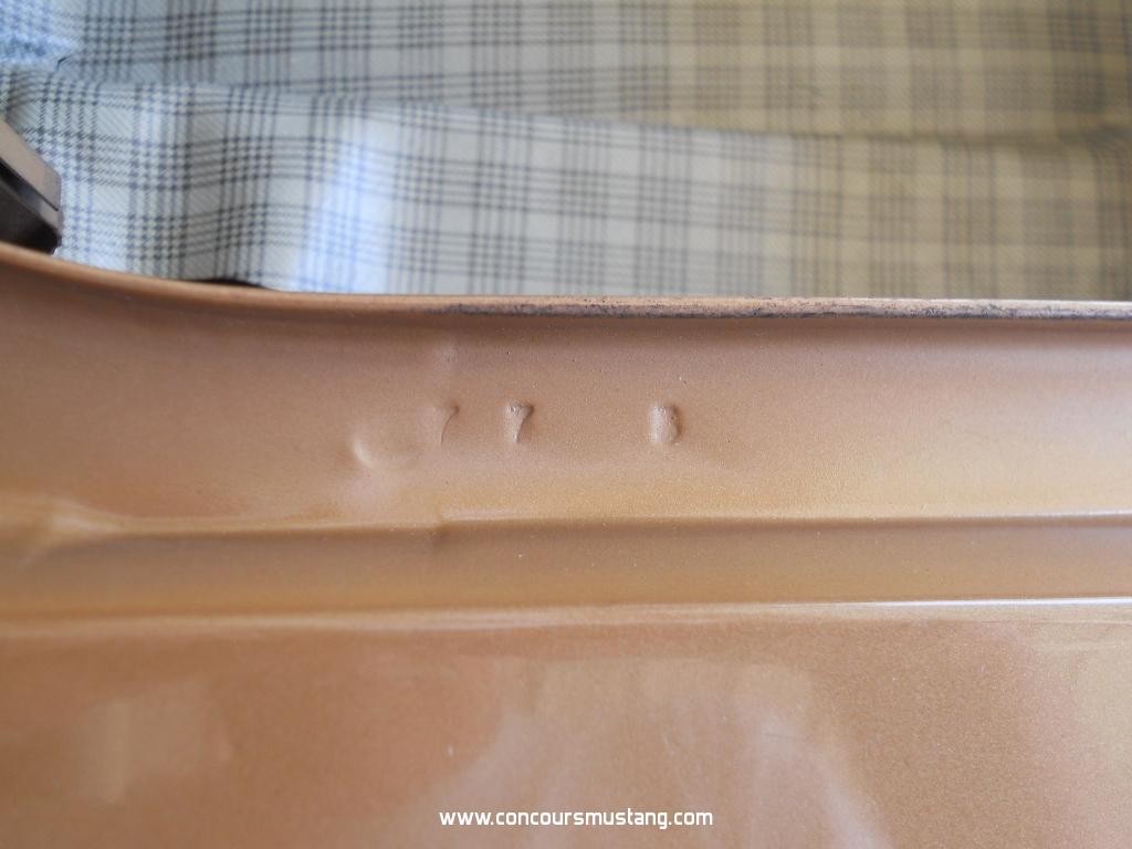

Date stamp on the trunk (area where the trunk lid seal fits)
Trunk lid stamp.

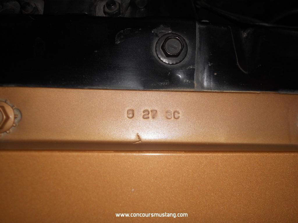

Fender stamp.

Those are all sheet metal date stamps.  The format is Month Day Shift/Plant, the year is not indicated.  On some pieces, the shift or plant (usually at least one of them) might not be there or a faint stamping.

Yes I understand how the date stamping works. But let me expand my question a little more. The date stamp on the fender apron (I am assuming that is what it is called ::) ) reads 3 3 D So does mean it was produced March 3rd? And I thought the shift was a 1 2 or a 3 so the "D" Dearborn??? The fender stamp is 5 27 3C and that would be May 27 3rd shift, but the "C"?

I believe the "C" would be the plant where the sheet metal was stamped.
Dave
A = Chicago, IL
B = Buffalo, NY
C = Cleveland (Walton Hills), OH
D = Dearborn, MI
M = Monroe, MI
W = Woodhaven, MI
65 Coupe Dearborn Scheduled Build July 9,1965 289/C4
+1!
