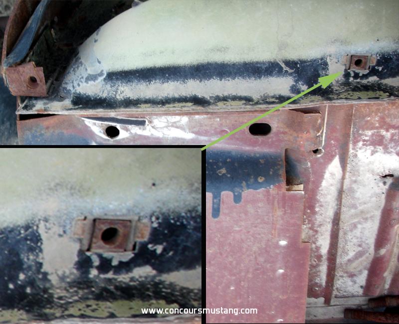

Had a request on another site for a picture of the "caged" nut used to attach the lower rear fender of a 67 Mustang. Example happens to be of a San Jose built car from the 7R1885xx if that becomes important. Not expecting it to be but does not hurt the discussion and sharing to include it "cage" has two visible arm that are positioned in line with the rocker panel. Hope this is useful to others if the question comes up

The nut does have a name, 359613-S2, and it is used on the body to attach the lower rear part of the front fender to the body (ref "1967 Mustang Body Assembly Manual", AM0016 pg 9 item L).

If your name was "John Smith", an ID number would verify who you are, or who you aren't. I just "shortcutted" the ID process for the hardware item. The "description": is: "5/16-18NUTPLATE,1.060L,0.780W,W CLIP". The number gets you more info.  ;)
One more thing: that nutclip is common for all Mustangs from 1964 to 1970.
