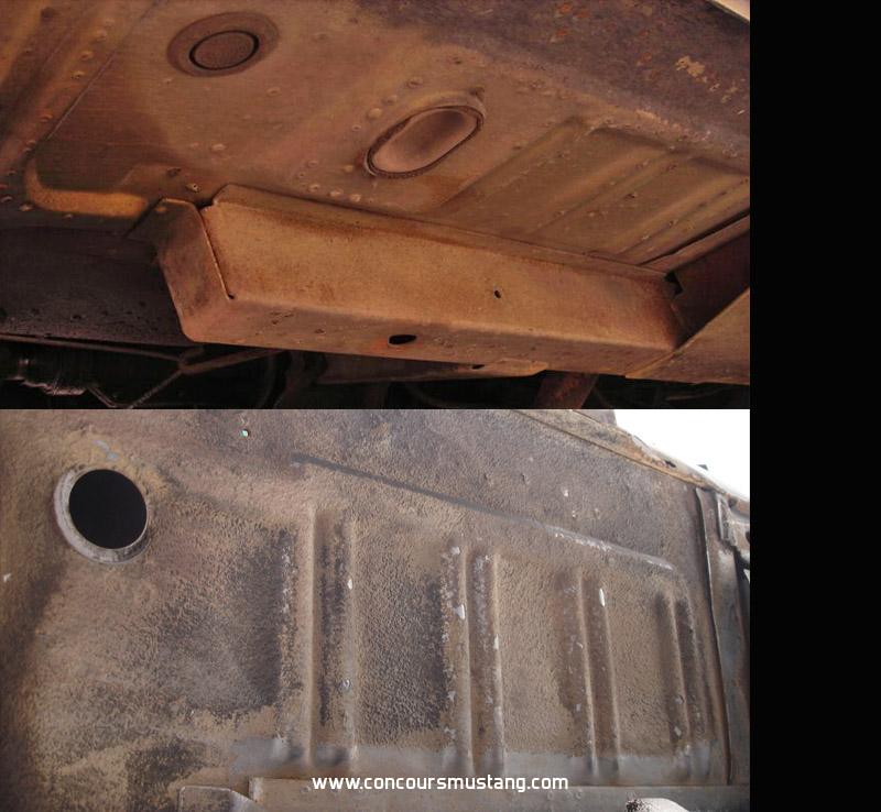

Posted a comparison picture on another site and though readers might benefit from seeing the visual differences between a 68 (on top) to a 69 (on bottom)
