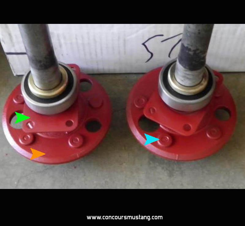

Help with color/finish on rear axle ends...see pic
« on: May 25, 2013, 07:24:54 PM »
Hello,
Need help with both the end of the axle and the rectangle plate (the red primer parts)...what paint color/finish should these be?
Thanks Much
Jeff
Re: Help with color/finish on rear axle ends...see pic
« Reply #1 on: May 25, 2013, 07:53:57 PM »
Green arrow - Recall Semi-gloss black but will assume the others will confirm or correct ;)
Blue arrow - Dark heat treated bare steel
Orange arrow - bare steel with brighter machined (bare) surfaces

« Reply #2 on: May 25, 2013, 10:30:32 PM »
Green arrow - Bare stamped steel in my opinion.
« Reply #3 on: May 26, 2013, 12:47:45 AM »
Green arrow bare steel as well.  I have been phosphating and tumbling them to get them to look close to original.
So to answer the questions here, none of the pieces should have any paint on them.
The only thing you are painting is the axle housing and the third member carrier.
Also missing the axle sleeves from what I see.  I assume these are 31 spline axles.
« Reply #4 on: May 26, 2013, 11:04:25 AM »
Thanks guys...appreciate the help. These are 28 spline axles for a 73 Mach if that makes any difference.
