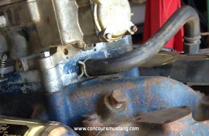

JASON.
Image from my unrestored 66 gt coupe x San Jose.  it has 3/4 of the carby spacer in engine paint and the rest is bare.
I know jeff has a engine image in his vast collection what shows to be a plastic bag of sorts taped around the carby spacer to prevent paint/dirt/items getting inside the spacer and into the intake manifold.
it is often a detail like this that is not reproduced on many restored cars these days. I also have a Dearborn example where the carby spacer has only a small paint line around the carby spacer so I guess it could depend on what the worker responsible for this process did each time round

Thanks Phill, this helps... I would assume this was very random as you say, so sometimes probably barely sprayed, other times fully I would assume.
Yes, missed on a lot on restored cars, as well as the exhaust manifold overspray. Just finally taking care of these details so wanted to ask.

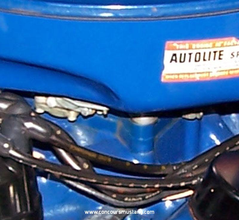

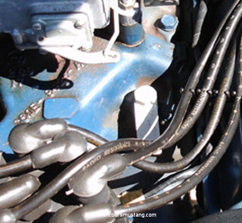

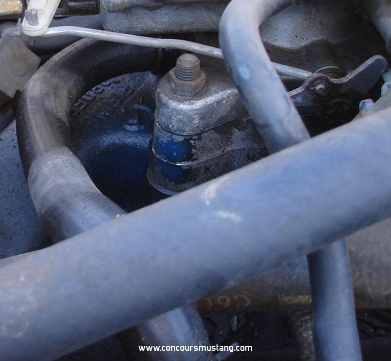

Sine this is an engine plant detail where the car was built isn't a defining point in the discussion. Also the practice was the same for all 289's so K code, 4V and 2V's all shared the same detail and practices
 Did check the assemble instructions for 66 289s and it does state not to paint the carb suggesting that the carburator was installed at the time when the engine was painted. Ford's instructions to the painters stated they didn't want the mating surfaces (intake to spacer - spacer to carb) painted and buy painting it with the carb in place they achieved that
Some of the following only show what remains of the blue paint after all these years while others are lower mileage and show more paint. Not sure how they masked the carb during the painting process of the engine

Interesting, in most cases it seems as though the full carb spacer looks to be painted... just the carb as you state must have been masked off somehow. Those photos basically show blue paint all the way up the spacer to the carb.
So I guess it doesn’t matter for the most part as it probably varied, as long as you don’t paint the carb itself.
Thanks for the photos Jeff, very helpful.

A number of the examples I posted did have engine paint on the studs still
