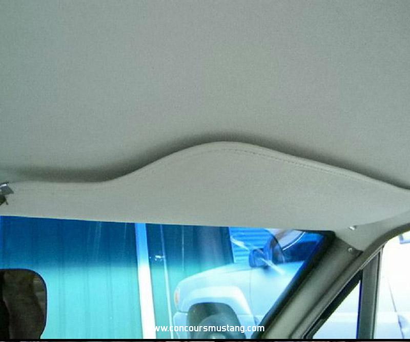

As a clue there one or more pictures of the color in the pictures of a Fall 64 coupe with the 29 interior code in the Unrestored Picture Thread section. Look for "Fall 64 Built Dearborn A Code Coupe - Unrestored Picture Thread" thread.  I-13 labeled picture especially
It shows a much lighter than the surrounding palomino painted parts shown.
A couple of other examples but be warned (as we always do) that colors can look very different in person verse on your computer screen
Not certain this is an original
And a different unrestored example

Based on the VIN 142548 it is estimated to be a Sep. 30, '64 assembly date. This would throw it into an early '65 production. It has 64.5 headlight buckets, hood and an Eaton PS pump.  Thanks for the pictures.  The came through well and sure look like parchment.  I will have to run with that assumption until I pull the windshield, back glass and windlace to pull the old headline out.
