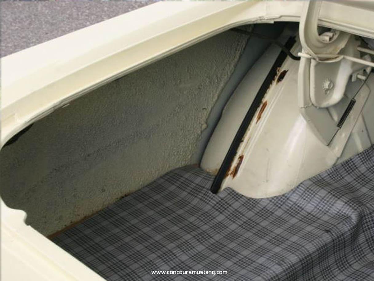

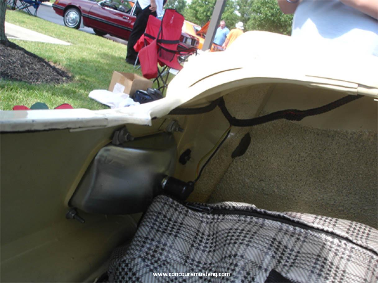

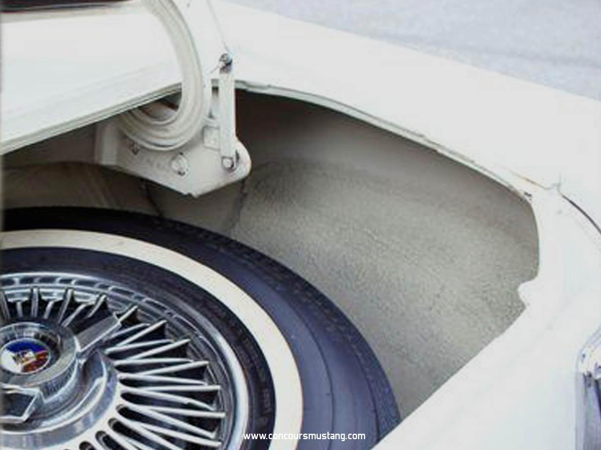

Couple of examples

Got it!  The pics put everything into perspective.  Thanks so much.

« Reply #6 on: August 14, 2014, 02:14:07 AM »
Jeff,
 Those are some great pictures. Is that an original example, or a correct restoration? is it typical to have the black strip caulk-like caulk pushed into the unused quarter panel hole after paint?
Current Project:
64.5 Black DB Cpe
5F07D1131XX  4/14/64
The stable:
65 Ivy Green Coupe 4SPD
70 Grabber Blue Boss 429
86 Jalapeño Red GT  5SPD
03 Sonic Blue Cobra Conv.
07 Black GT500 Cp
Re: Do you think this is the correct amount of overspray? Dearborn Sept 64
« Reply #7 on: August 14, 2014, 02:22:55 AM »
Jeff,
Normally I don't save pictures of many restored cars. If I do its for the purpose of showing what not to do ;)   thought not always - so if you see me taking pictures please don't assume
It's a very nice unrestored car that came out for a show a few years back after not being showed for maybe 20 years before that where I saw it before we had digital camera
Yes had to seal those holes
