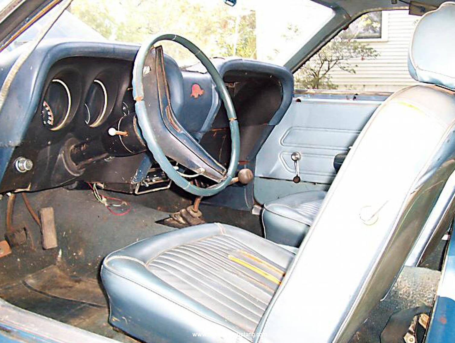

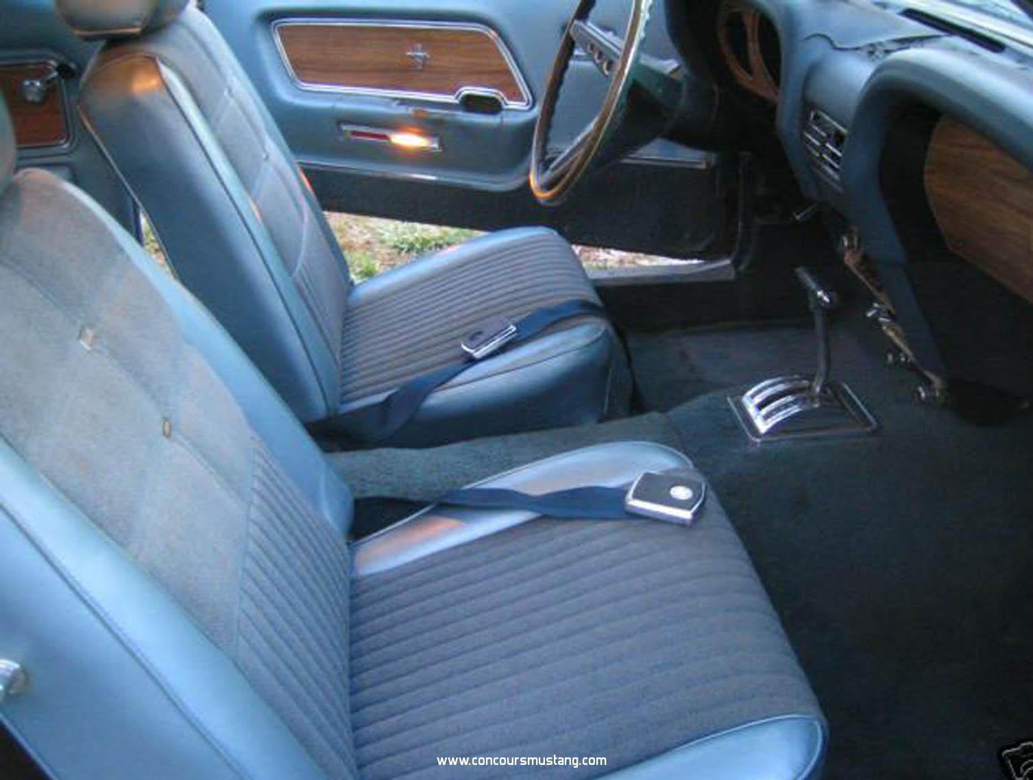

Hi, I'm new to the forum but I think you guys may be the only ones that can help me.  I'm trying to return my blue interior back to concours.  However I've seen 69 "Light Blue" interiors where the dashpad, console, etc matched the door panels, seats, etc.  But I've also seen 69 light blue interiors where the dashpad, console and carpet were of a darker blue color than the upholstery.  Which is correct?  I've included two pictures to demonstrate what I'm talking about.

I'd say it would have to do something with deluxe interior vs. standard interior. The top photo is a deluxe interior and the bottom photo is a standard interior. JMO

The deluxe one is more correct.  The top one maybe/probaly dyed, but the bottom one surely has been dyed.  I have a 70 coupe and the dash is light blue. It match's my 69 driver coupe and I have an NOS blue dash pad going into my 69 R code coupe. They all match.

According to the 64.5-73 Mustang recognition guide, Page 153,  the top photo looks to be the Grande' Deluxe Décor Interior (not dyed). With the Unique Grande' Bucket seats w/ Hopsack cloth inserts.
Note: Under, Interior it says "including the following items".
Almost identical to the Mach1 interior except for the Mach1's high back bucket seats.

Yes the first example is from a Grande. Since the po never mentioned which blue interior or body style, I thought we would throw it out there also.
The interior differs also in the rear quarter trim (on coupes)  and passenger side dash trim

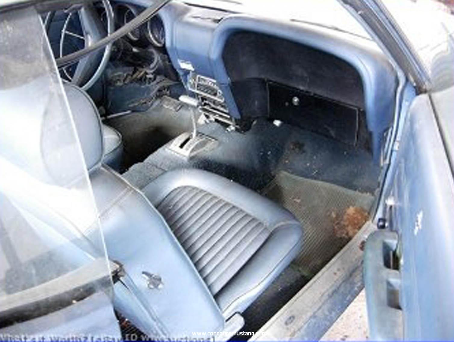

Wow, lots of good comments...  my 69 fastback was built at San Jose with a "2B" light blue Kiwi vinyl standard interior.  As many photos show, the kickpanel is much darker than the doors and it seems like Ford was trying to tie the color of the carpet, kickpanels, seatbelts and dashpad area together.  Here is a picture of my car - I believe everything is original.  Note the color of the seatbelts, kickpanels, etc.

With the blue exterior (look like acapulco blue from looking at the door jamb) and the two tone blue interior, that would make for a really neat and eye catching color combo.
I noticed your interior door handles/arm rests are dark blue also.

The car is actually Winter Blue.  The driver side armrest in is bad shape however I think you may be correct... it does almost look like it matches the carpet.  I wish there were more documentation on what Ford was trying to accomplish with their interior colors.

That arm rest could be a 70?  It does look dark compared to mine. Mine are much closer to the door panel color and they are originals.  but ya never can say never.
