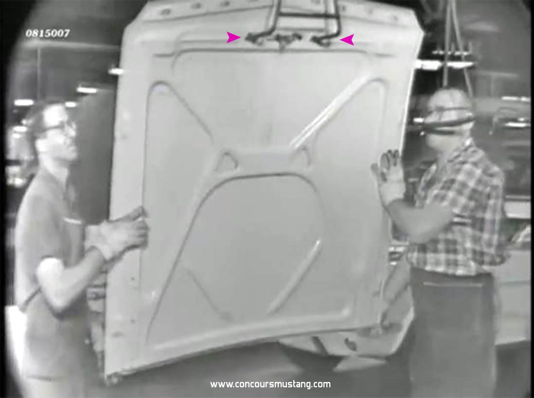

I'd like to duplicate the paint finish on the underside of my hood and noticed at the 2:21 mark of the Martha Reeves video the witness marks left by the rack that held the hood when it was painted.
Does anyone have any close up shots of an original hood with these marks visible?
What color primer would have been under the original paint?  I believe this video was shot at Dearborn in the summer of '64.

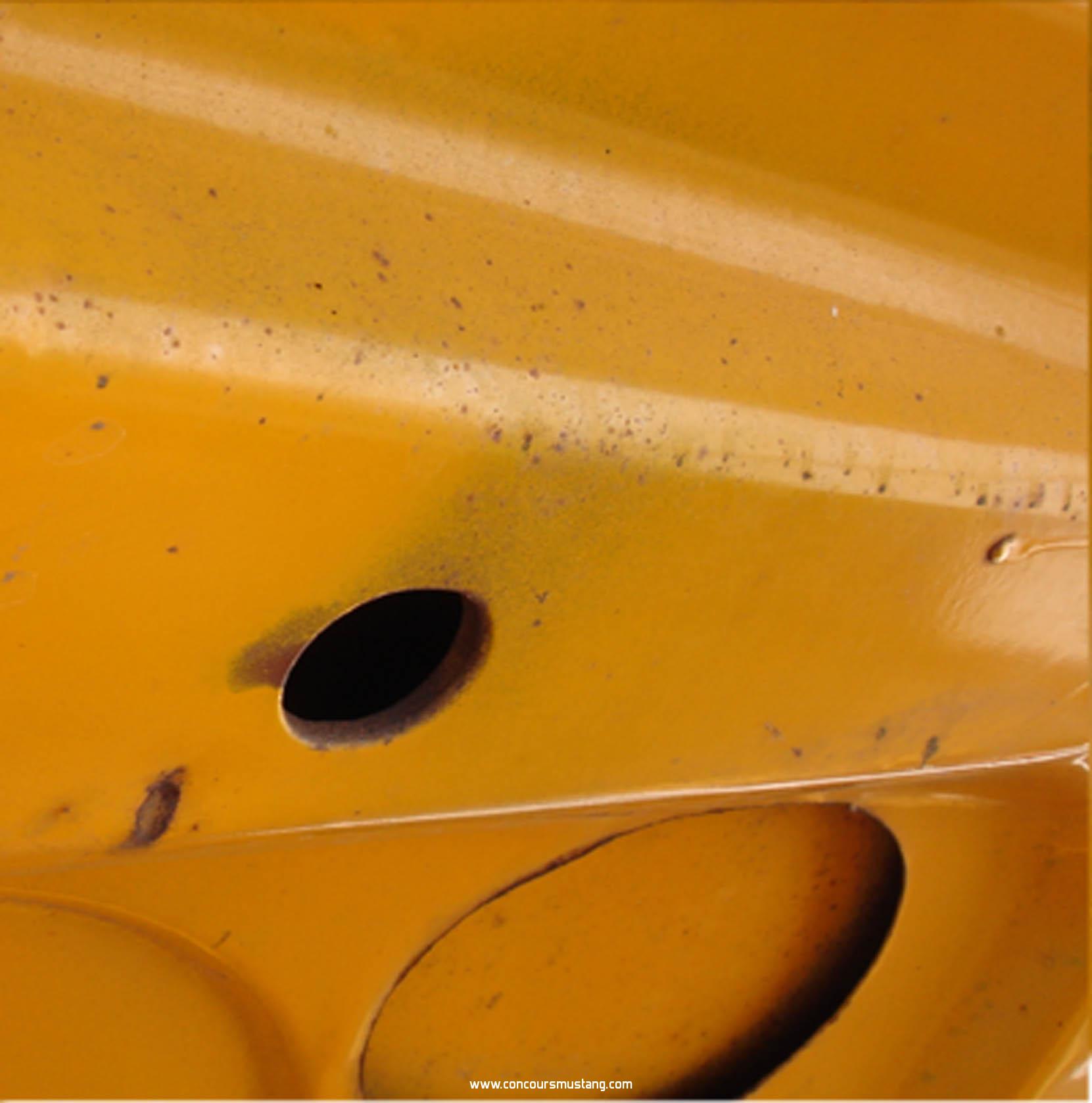

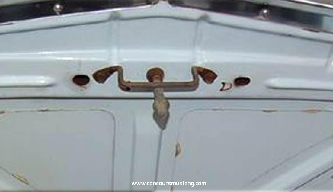

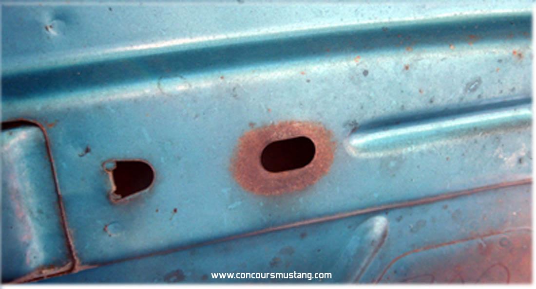

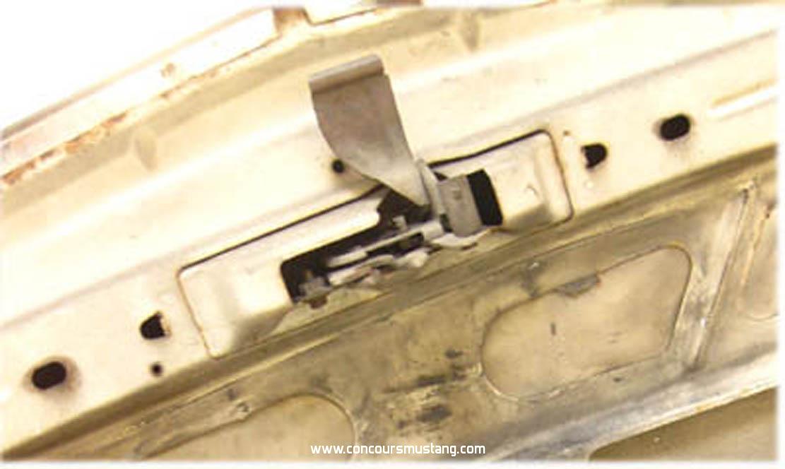

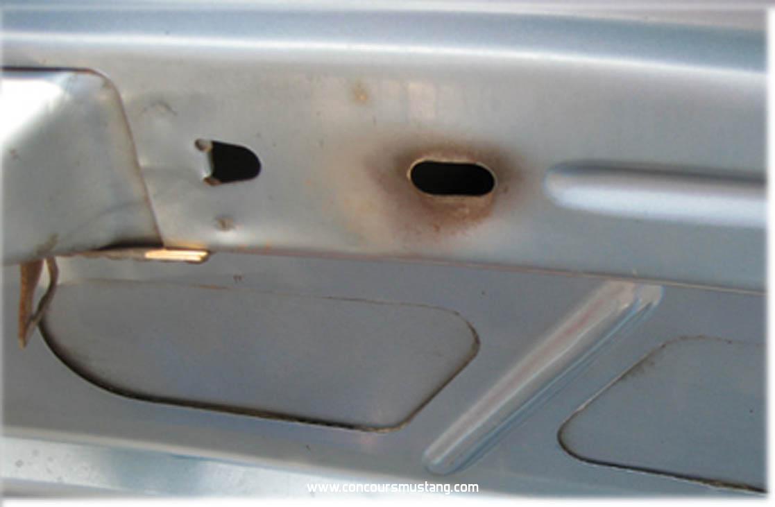

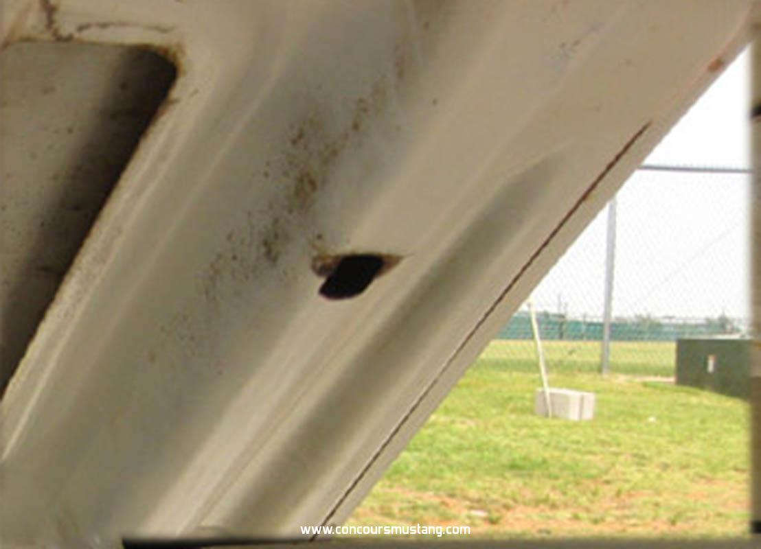

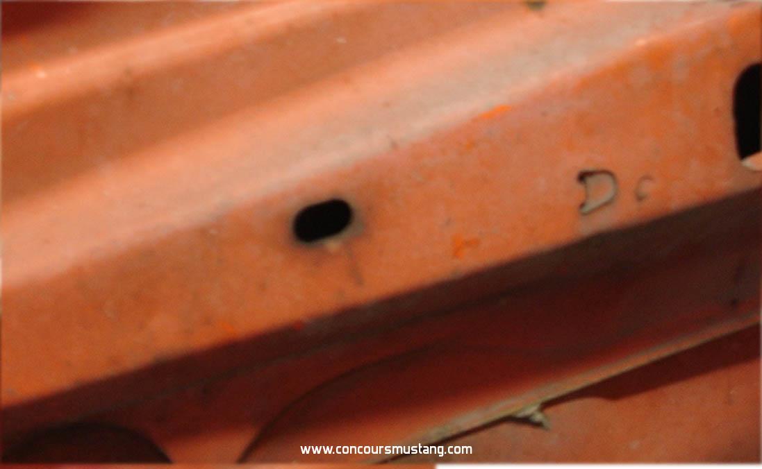

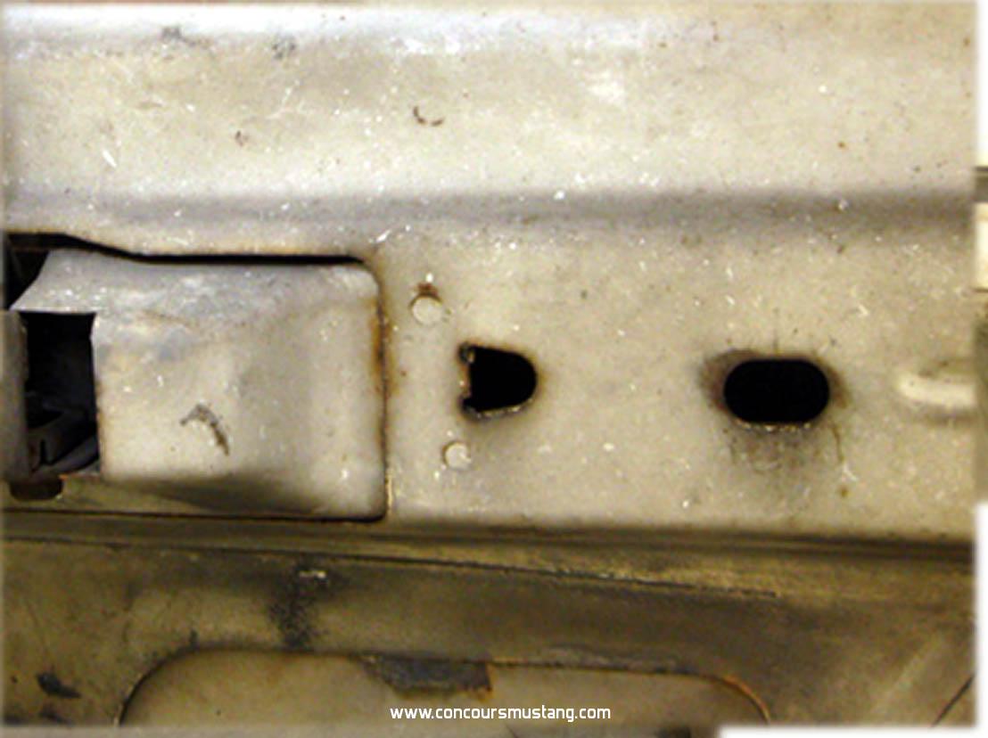

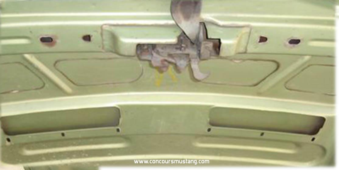

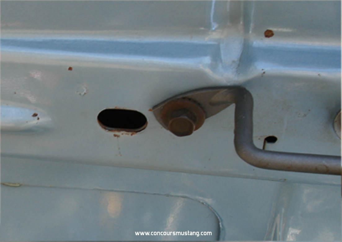

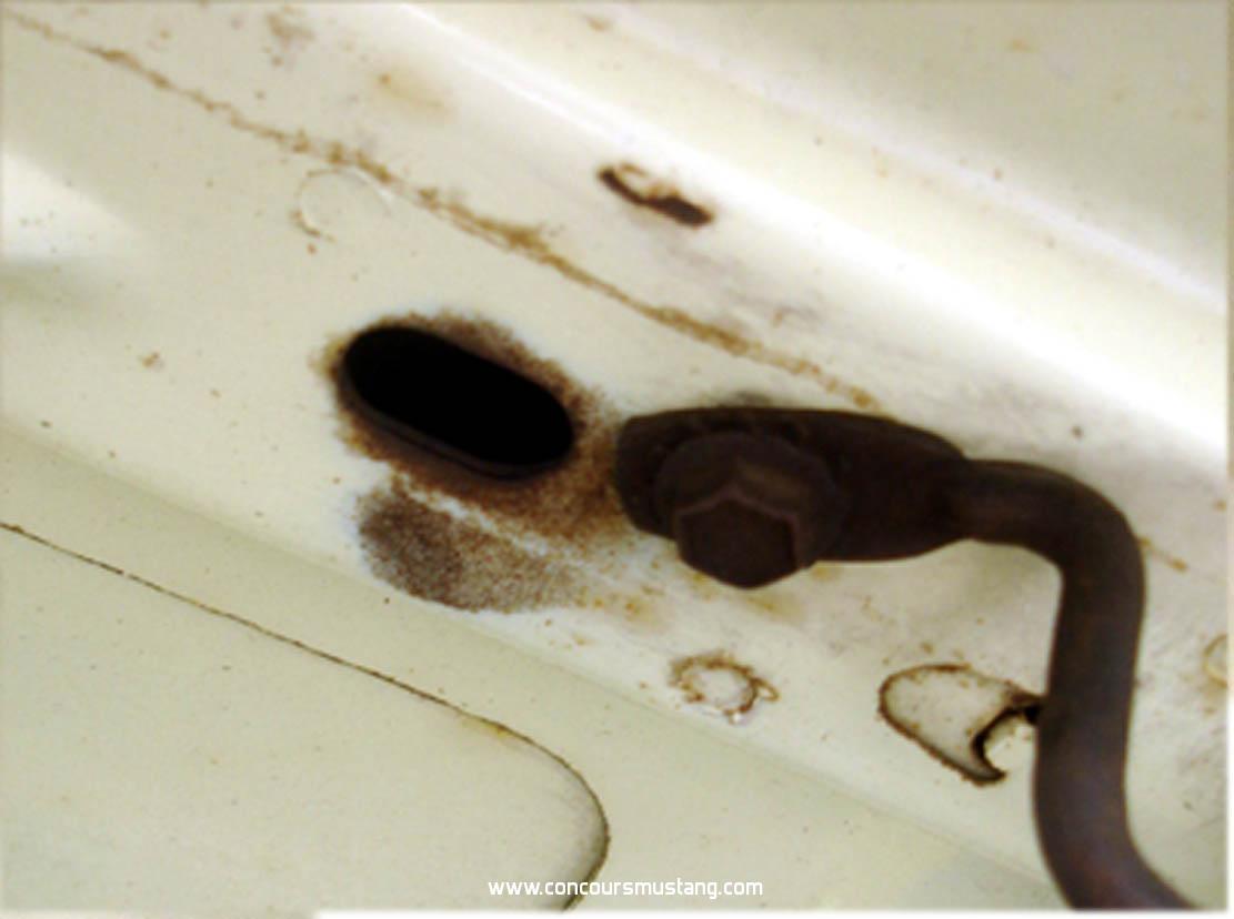

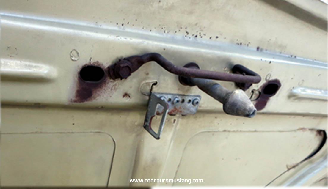

OK went through some of my pictures and found the following examples. The shadow produced on the bottom side of the hood from the fixture differs allot from car to car. Again this paint detail, like others, is likely IMHO due to the different heights of the painters, effort put forth during application and other unknown details. If you notice that some shadows are above, to the left, below  or all the way around - likely the results of where the painter was standing at the moment. Not all original paint cars show shadows so at least some painters got full coverage as Ford likely wanted
NOTE: When viewing the following well aged examples, understand that the effect of the thinner paint and primer application has resulted over the years to less fade and more surface rust. On those examples were rust is visible, I would say, what we see is 100 times more noticeable than it was on the day the car was completed
Skyway65 I removed the specific year of your original title so that we could include many more years in this thread since this is not a detail specific to 65 though that is where you noticed the fixture originally
65 San Jose example
65 San Jose example
66 San Jose example
66 San Jose example
67 San Jose example
67 San Jose example
67 NJ example
67 NJ example
68 San Jose example
70 Dearborn example
70 Dearborn example
73 Dearborn example   In 71 Ford changed the location fo the hole that they used to hang the hoods from during paint application

Reviewing the picture from the video at Dearborn is obvious that the hood hook/hanger we see is not the one that the hood was shot on - no color on the hanger itself.  Just wanted to point that out ;)

Yep, noticed that after watching the video about 8 times!   8)
