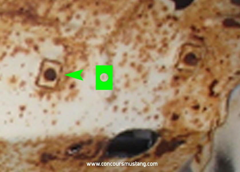

The 65-66 style is a thick round (well almost - one side is flat)  while the 69 is a thinner rectangle shaped (almost square) Both held to the car is a different fashion
Just had to replace one of them on my 69 that had fallen out
 65-67 style
68-70 style
