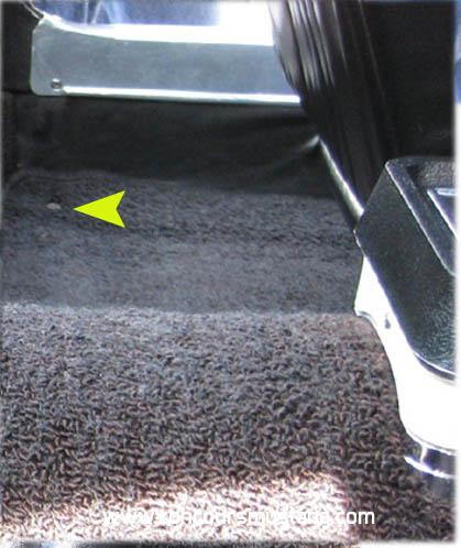

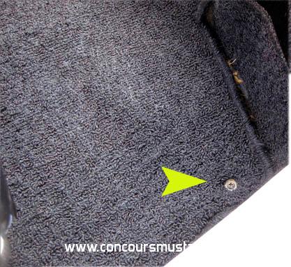

Depending on model year and body style there can be an additional 4 screws (other than the four for the seat riser) but more often an additional 2  installed originally.
Example early 65 fastback carpet with the vinyl sill covers the rear corners are often held down with that dark screws so that those corners (nothing else is there to hold them down) don't come up and cause people getting in or out of the back seat to trip I would guess.
Doesn't example why there are all those screws but might help to eliminate some additional ones ;)
An example - location varies and is a bit random from the ones I've seen
