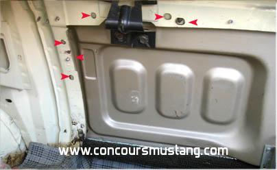

Why we're on the subject of the rear panels remember that they are painted only on the surface facing the interior. The small edges visible from the trunk side are bare/natural light tan and judges make a point of checking them since they are often found painted either by earlier sloppy trunk repaints or using the interior color to "freshen" the look up incorrectly

Jeff, forgive my ignorance.... but I don't follow you..... what edges are you referring to? Edges of the unibody panels? Edges of the plastic interior panels? Edges of the trap door? I don't understand your comment.
The only thing that immediately comes to (my) mind, is that I've noticed very little paint applied to the edges of the trim panels, such as that affixed to the top of the tram door.

I believe that Jeff is referring to the back sides of the interior panels.  These should be the "natural" fiberglass color, not painted.  You can see these from the trunk.  See the picture - area at end of pointer.
Sometimes a poor paint job in the trunk results in this area painted trunk (body) color.

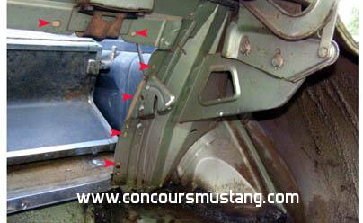

I believe that Jeff is referring to the back sides of the interior panels.  These should be the "natural" fiberglass color, not painted. ...................
+1   Arrows show all the little areas that can be seen from the trunk side
