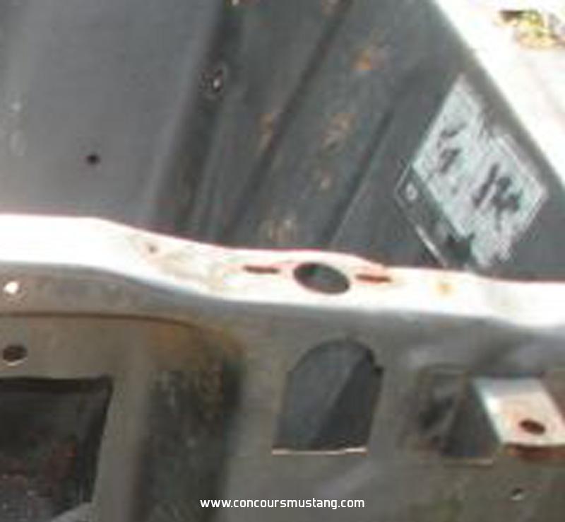

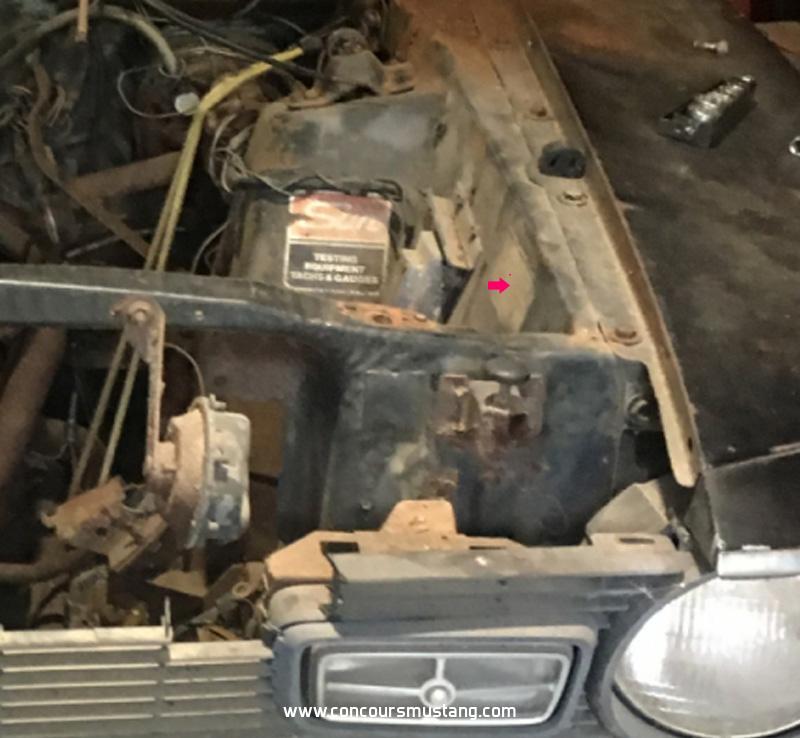

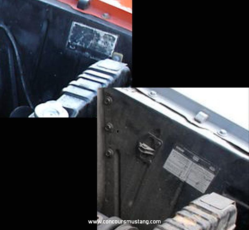

Sorry difficult to make out in some cases or see the finer details but location is consistent based on the production period you identified.
Likely another dozen examples were the pictures were cut off so that you could not see the front inner fender panel but no sticker visible on the shock tower. Of course you can findyour fair share of them mounted there on "restored" cars

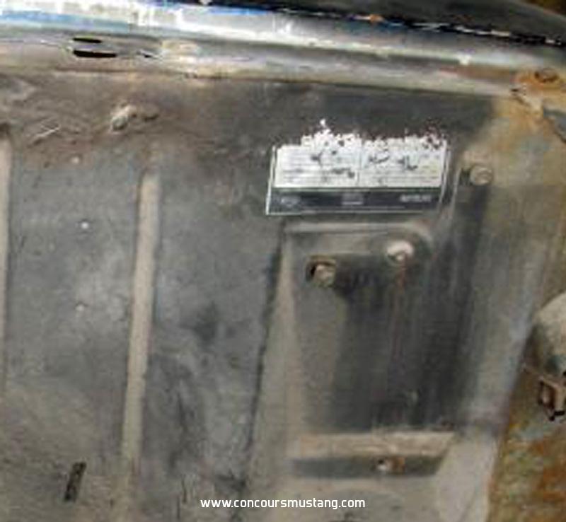

Closes to your car  - 0T1127xx built 10/8/69. Very poor picture but attached to the forward section of the inner fender panel
0T1021xx
0T1066xx
0T119xx

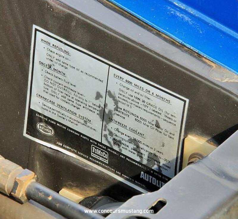

Best and clearest look at a fairly early car 0T114xxx

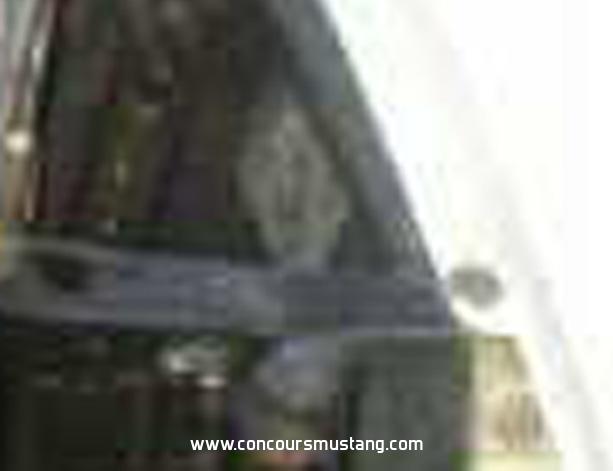

For some of the others that will be viewing this thread From other thread postings
0T 1200-132xx
Dec 69 examples
0T121xxx

Jeff; Wow, this is great.  Its is clear that the decal should be located on the drivers side near the washer reservoir.  It appears the early decal was used on a car 1 day after my build date.   Thanks, I really appreciate the feedback.  Alan
