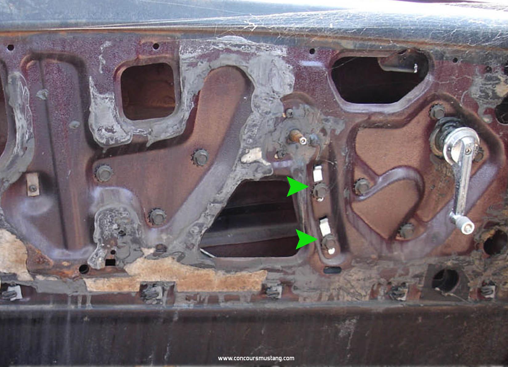

Putting in the windows of a 66 coupe.  We have most of the window in but there are some pieces left over.  Does anyone have a good picture or diagram of where the stops go?  Looking at the diagrams in some of the assembly manuals and I don't see all of them.  There is one that has a rubber coating that is angled at the end...

Can you post a photo? Both the Door and Qtr. Glass have Stops that fit that description.

Putting in the windows of a 66 coupe.  We have most of the window in but there are some pieces left over.  Does anyone have a good picture or diagram of where the stops go?  ..............
Hope this helps  These are the stops that restrict the up and down movement/limits of the crank arm

Are they either or both of the circled Stops in the Photo?
Those are the ones identified by the arrows in my picture

That's what I needed Jeff  ;D  I appreciate it...
