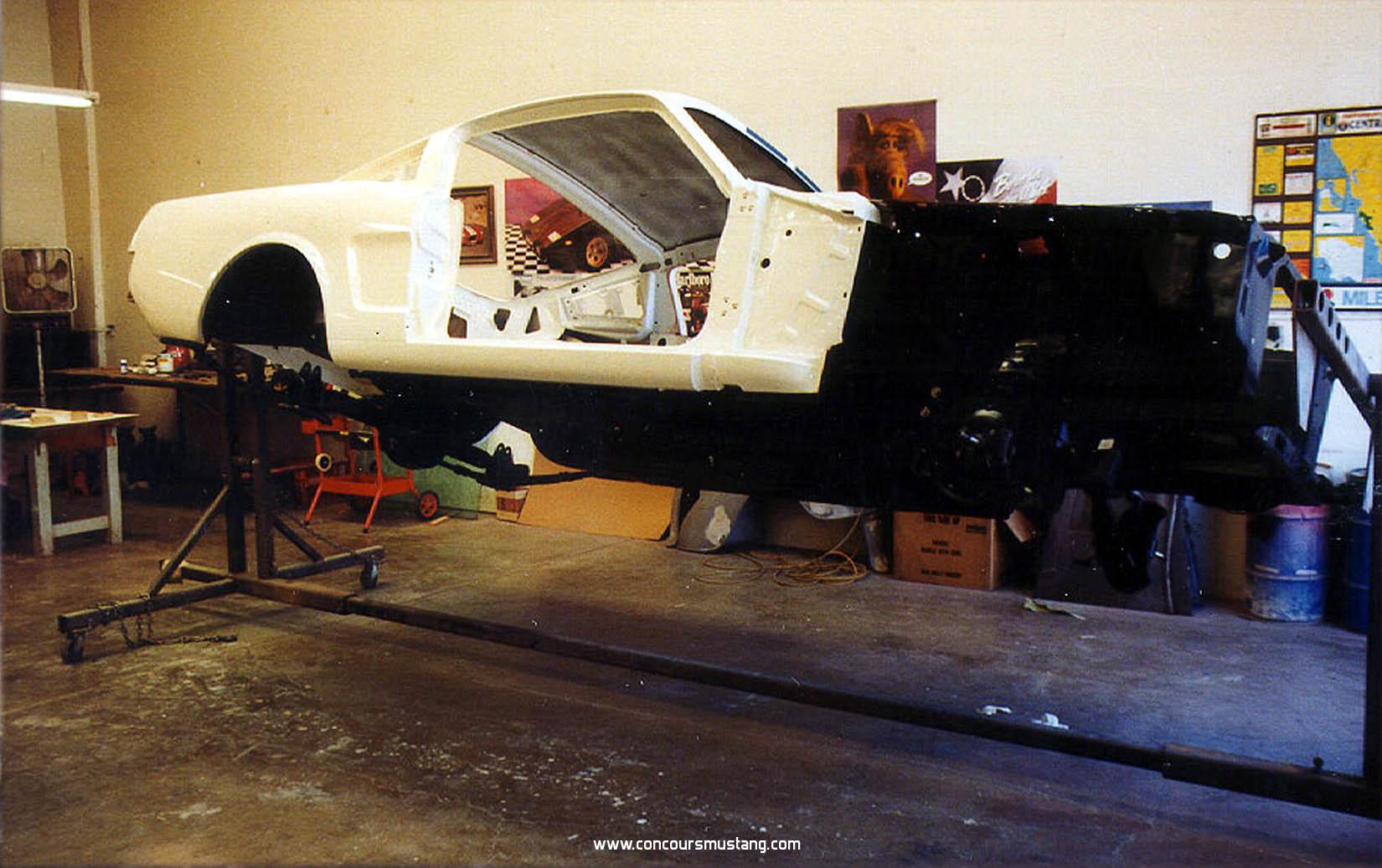

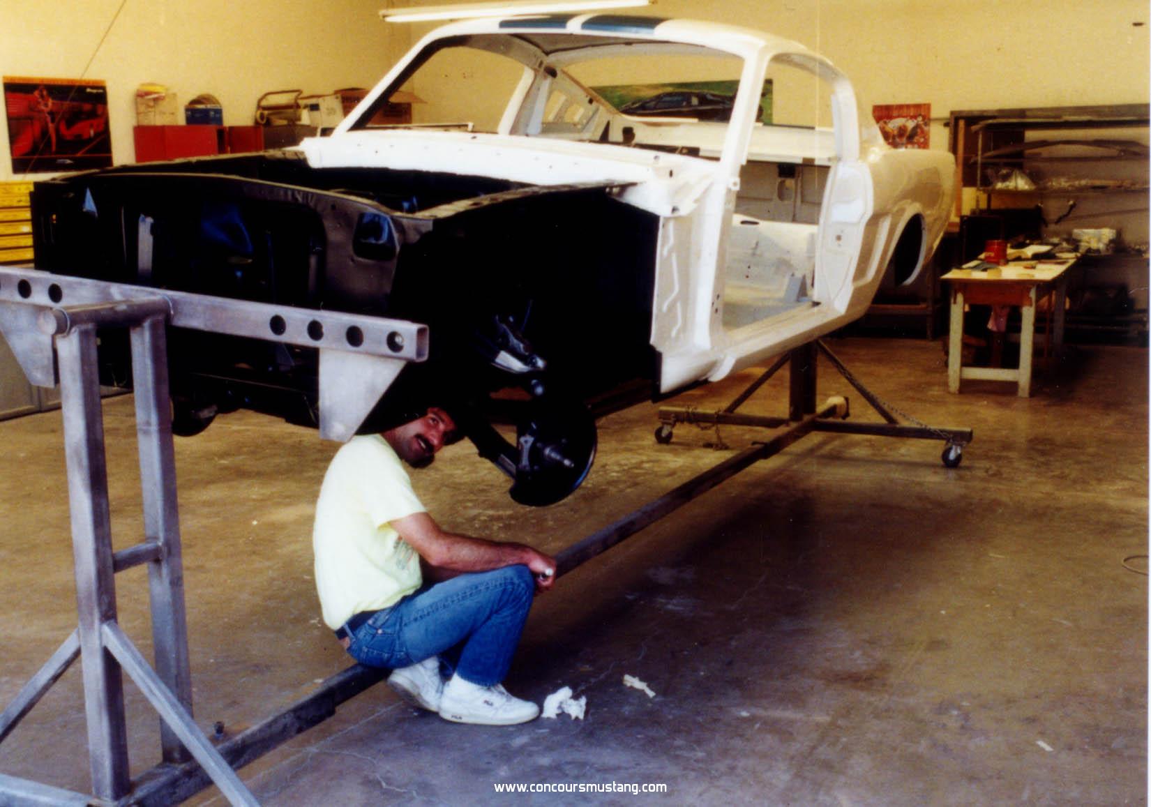

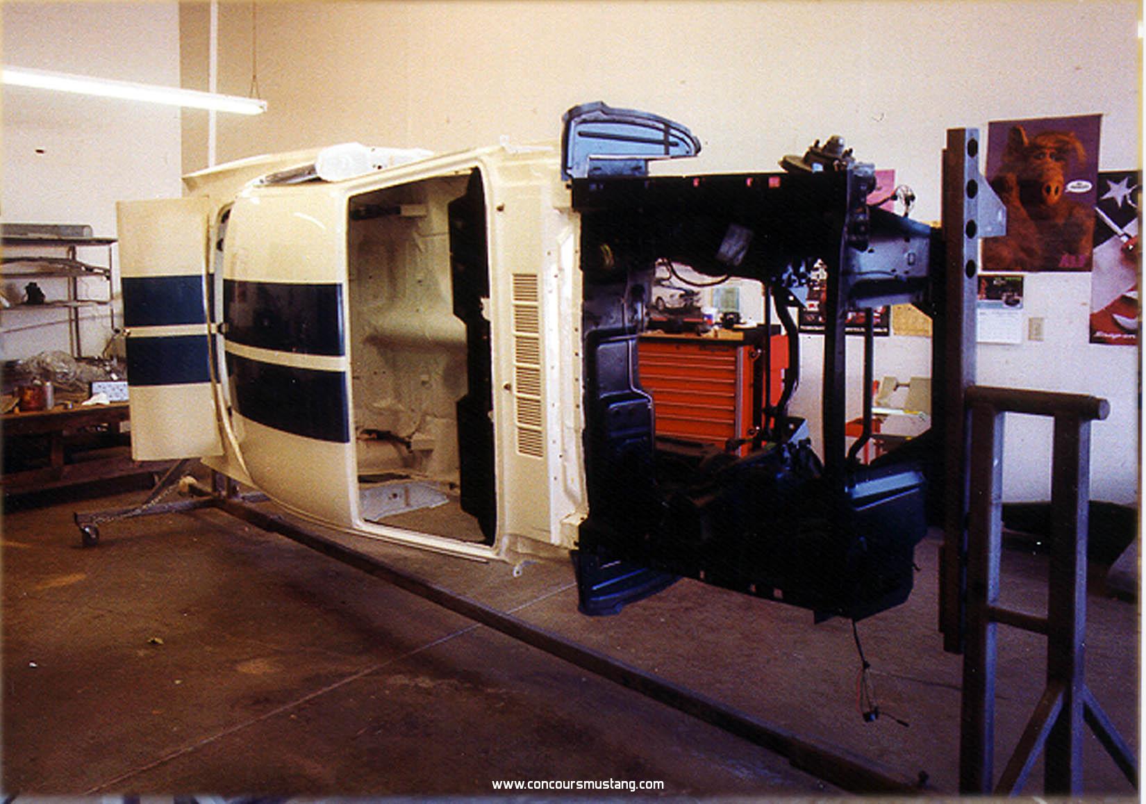

Never is truly balanced - at least on the ones I've used. But as long as its not too much and we can still turn it (buffering it when the heavy end is heading to the bottom)  it hasn't been a problem. One I have (built for me by the owner of the first concours car I did) has it's rear brackets designed straight into and attaches at the bumper bracket holes for the rear bumper. Front (going to the front bumper bracket attachment points) is offset down to make up for the alignment difference. To hold it on its side we simply held it in place using a chain (notice it at the back of the rack in the pictures )
Not me but Donny. The shop was not use to cars as common as 65 Shelby's. Typically they built Peirce Arrows for Pebble Beach competition
Heck of a learning curve especially that long ago
5S341 at SAAC National in Portland (Not Watkins Glean like in the registry)  - 1st place in its class ;)
