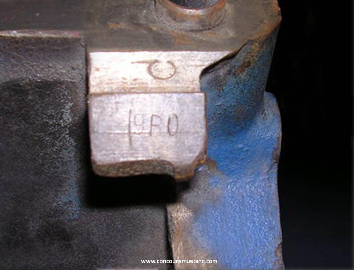

Look here ;)

From the photo shown, it looks like this stamp would be on the passenger side, unfortunately even after cleaning up the pad shown, I can't see if a stamping is present.  Might have to wait until the engine comes out.

     The assembly stamp on my 8 H 17 FE block is on the left rear ' lug '  and I was able to read  8 H 27 after great effort driven by curiosity.  The assemblers initial has eluded me thus far.  The cars ' actual production ' date is 9/19/68.  Brian
