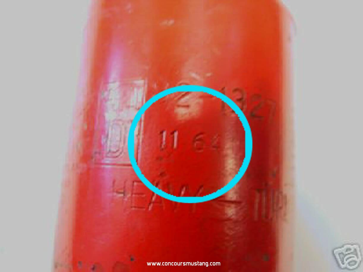

Where are the date codes on   Koni rear shocks and how to decode the date code, thanks.
Re: Koni shock date codes
« Reply #1 on: June 22, 2014, 05:22:05 PM »
Incorporated in the stamping on the upper body - if they are period correct they are all numbers (example - 4  65) with month then year
Need to get the pars dating article done - so that we can have allot of these handed and available when members need it
Its on the short list
