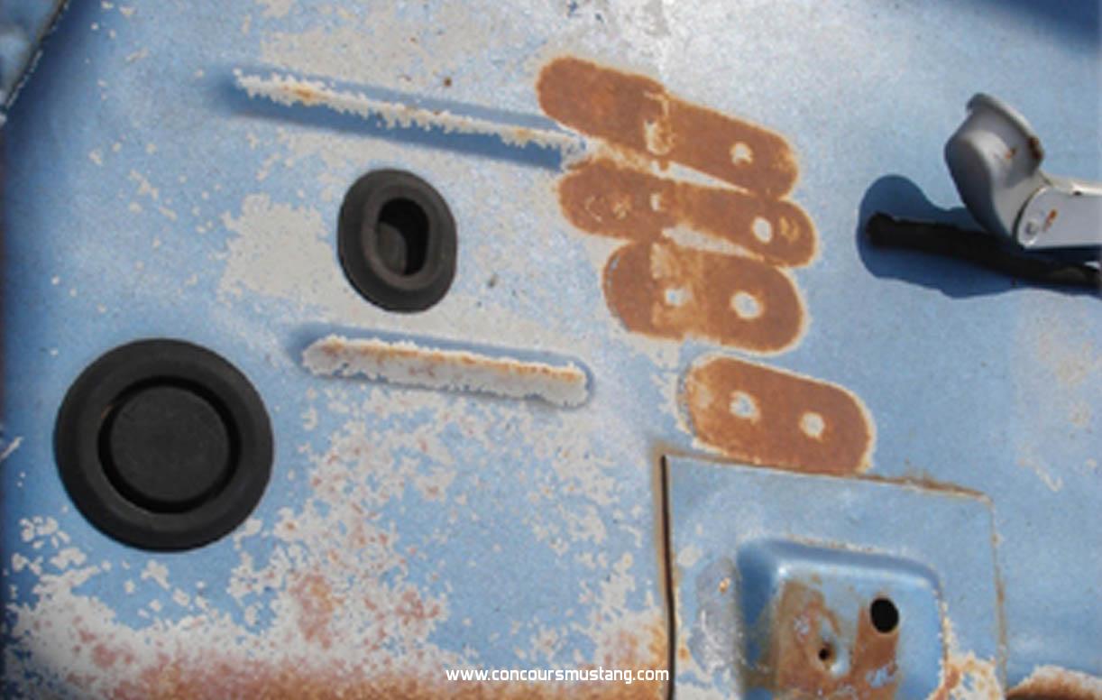

Agree that they were suppose to be and are the vast majority of time body color. And I would suggest they be returned that way. Seen a few even installed upside down (painted side towards the door) by mistake.
Here are a couple of original examples to illustrate how 69 Dearborn's were  (guess that is the one your working on) The painting was a results of the workers normally placing the plates on the cowl during the cars exterior paint application. Example below is from a coupe or convertible - the reason why there are two pair of plate shadows. It its a later 69 car this area is covered with engine compartment black covering over this detail

« Reply #4 on: July 06, 2014, 08:23:30 PM »
I was wondering about the bolts because mine showed no evidence of any paint.  The last picture definately supports this, pretty cool picture.
