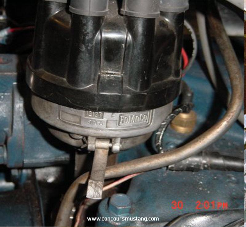

Think I see three specific needs in your original post. All appear to be generic (all plants) questions since these items were all installed at the engine plant not at the car plants
- What is the correct routing of the steel fuel line from fuel pump to carb?
Since your car would have a filter at the pump you would have a solid (threaded fitting to carb front bowl surface) rather than the 66 fuel filter there.
Here is a picture on an engine from around that period
Another from 5R1637xx
Close up of bend - ignore the owner painted the intake blue
