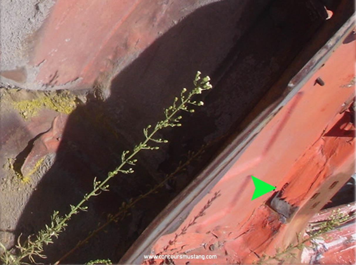

 After much searching, I came across an old post of Jeff's showing pictures of an early car. It almost looks like they taped over the un-used tabs. Does anyone know for sure what the technique was?
The black car is my car, and the yellowish car  was photographed by Jeff.

Those are probably just alignment tabs, saw the same thing on the pace car coupe I did.

« Reply #3 on: August 11, 2014, 12:43:56 PM »
The pic shows is as the car was during tear-down.  It's not an area that would be screwed with normally, especially if a car had a normal re-spray.
I don't recall how we did it on the pace car, probably some seam sealer over the top of primer, primed again and then color.  Factory probably installed seam sealer on bare metal.

My early 65 Dearborn convertible has the same tabs...covered with a piece of tape then sealed/primed/painted.  I've got pics somewhere

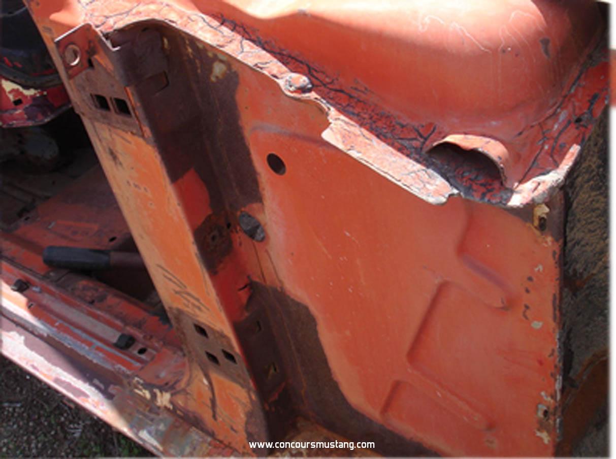

Re: 64.5 Hinge Pillar Detail
« Reply #6 on: August 12, 2014, 12:43:56 AM »
Went through the collection (looking for pictures for the tie down thread) and found the following that might help. Not the greatest pictures but they were not taken with the focus on this detail
5F08D176922 - nothing there any more (too much sun exposure) but you can make out where the tape and sealant was applied
5F08D114168 - Just enough to see the tape lifting and the sealant
Hope this adds to the understanding of the detail and the plant practices

There it is!  :)
Thanks Jeff. Guess I'll use Gorilla Tape, and sealer with a brush after the last coat of epoxy.
