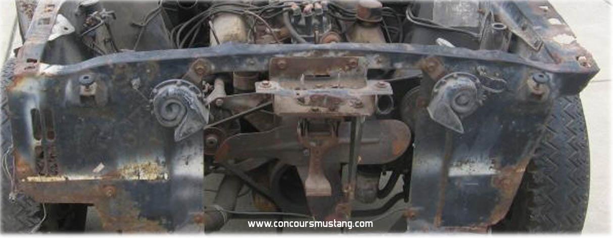

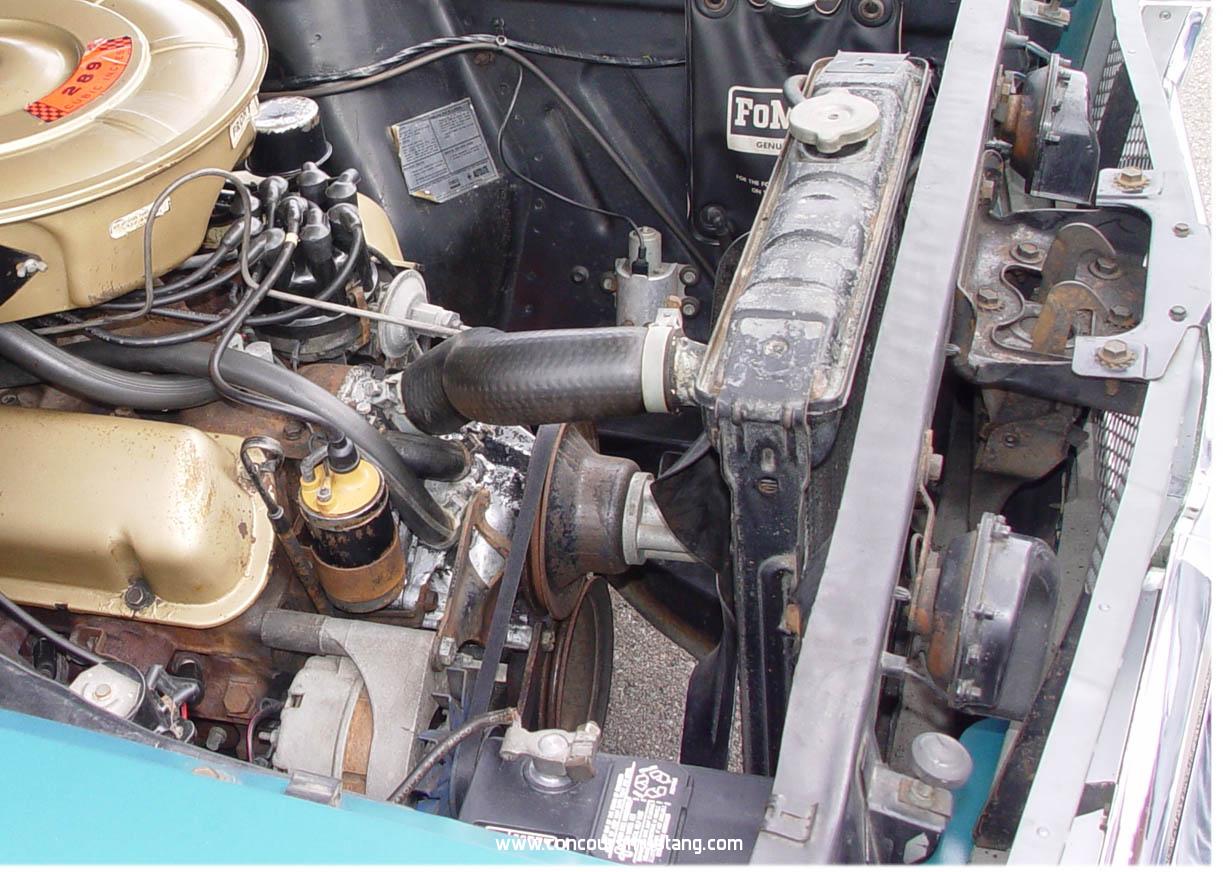

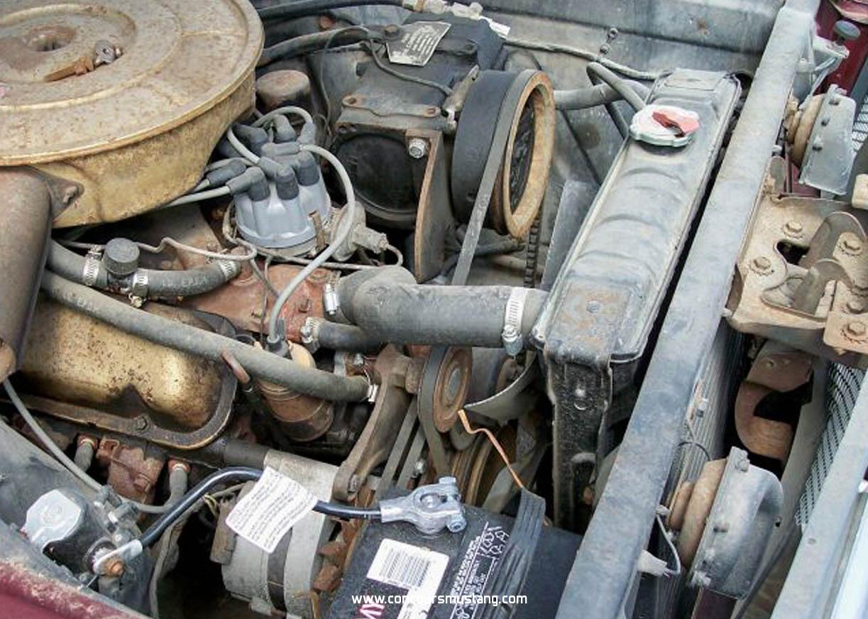

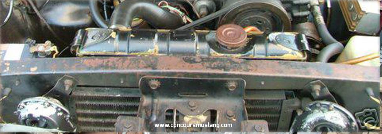

Never really paid attention which one was high or low - instead try and focus on the shape and direction of the horn. With that said here are some 65 examples for you to consider. Hope it answers your question
I tend to remember them as both curling in and downward in towards the center of the radiator as shown in the following pictures
Did recall your working on a Dearborn so those are the pictures I included and why some of the details look different from those that are use to San Jose cars ;)
