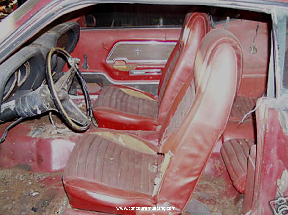

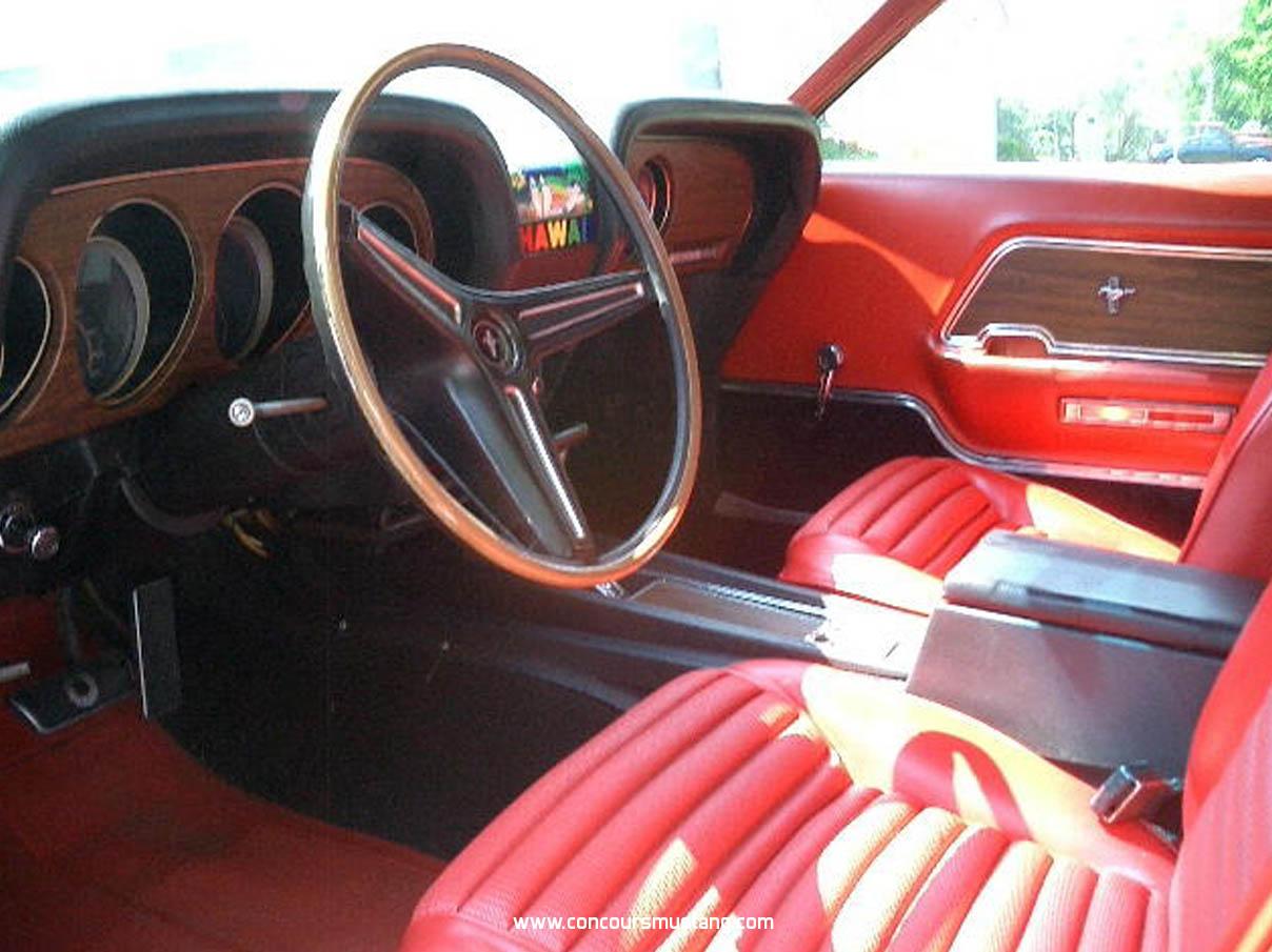

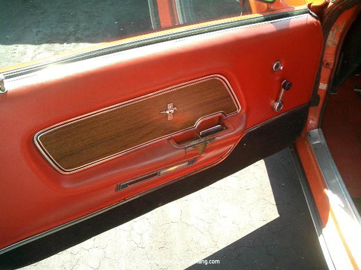

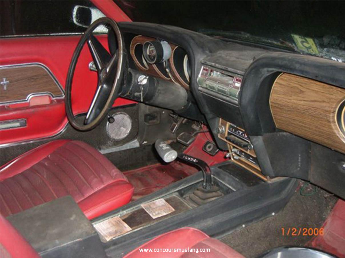

You lucked out - have some pictures
Unlike the 69 and some of the other colors it appears that the red interior didn't get a color matching dash pad in 70 on Mach i's and other red interior cars. Because the black carpet was used the kick panels are the same black as in all the other black interiors - lucky you
On this example the seats have been redone. Interesting heater delete export car
