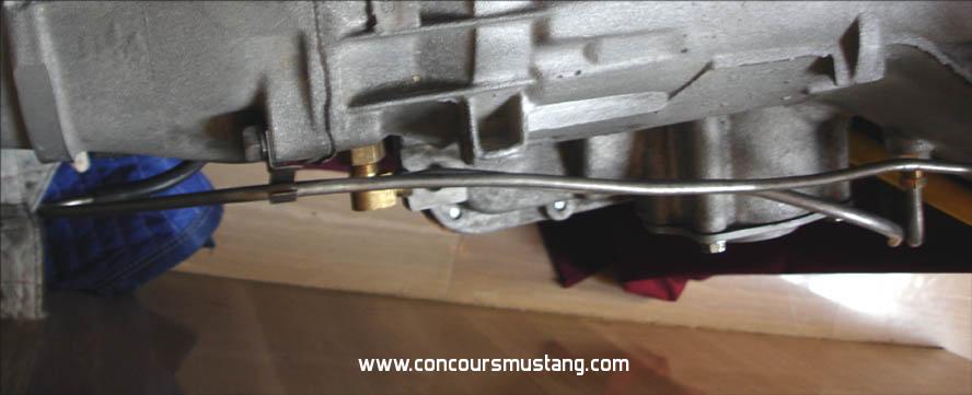

Anyone have a photo of the hard line routing from the modulator to the bell flange?
I have two lines, different bends, and some clips that don't seem to line up.
Alternatively, I'd guess a 67 or 69 would be similar..... web search came up with various routings, looking for correct...

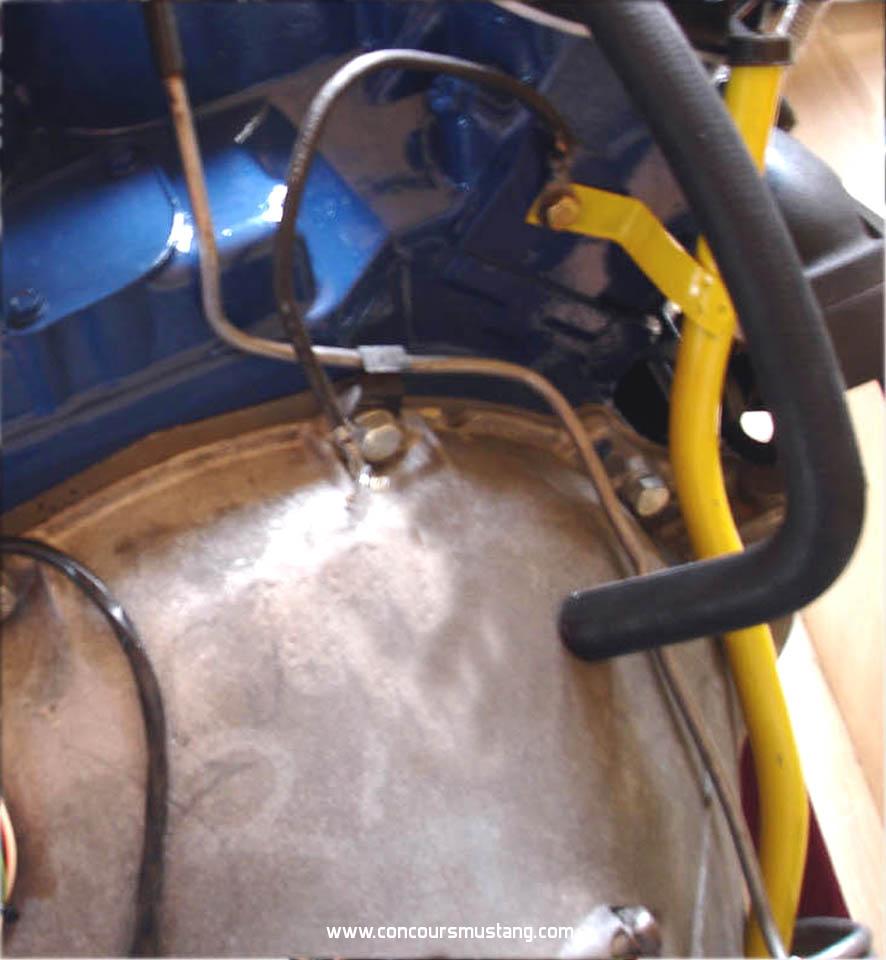

Hard to get pictures since most are in cars .. and ones out of cars often have the vacuum lines off for some reasons.
Looking at my pictures I can offer the following - identified as a 68 C6 application. Hope this helps

Thanks very much for the photos.  Confirms what I thought, the two I have an old one from "somewhere", and a new repro, don't fit the application.  At least I have the right clips!  :)

 Current reproduction from various suppliers are not even close. I make up my own
