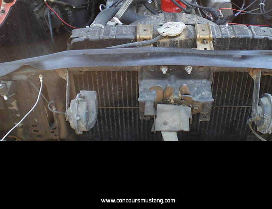

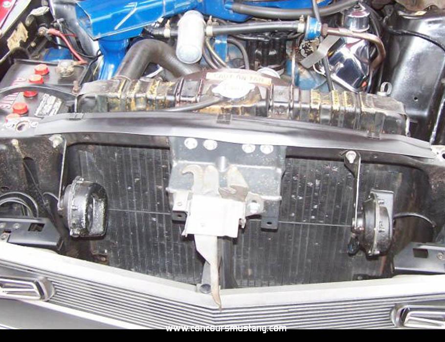

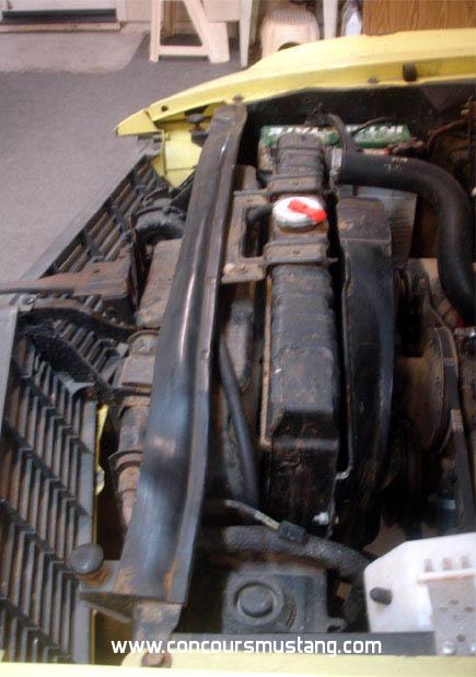

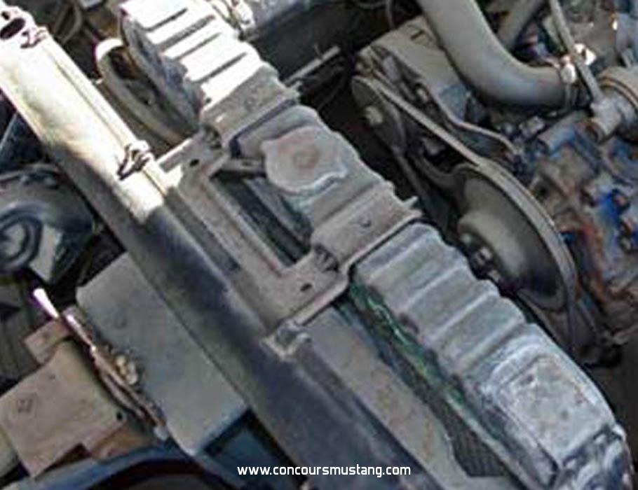

Yes agreed Ed 70 seems to be a very confusing year for the application/usage of the radiator support to hood seal. Have not been able to identify any pattern like what we see in earlier years. This is compounded by the lack of evidence left by the installation unlike earlier years.
Not allot of examples but it appears (if you can draw a conclusion from these) that they started out with the staples then went to the clips.
0F10005x seal
0F1214xx seal
0F1631xx seal
0F181xxx seal

Thanks jeff & it looks like ford started out with long stapled version looking at early serial #s then the short clipped on version on later serial #s  Your 4 pics show 3 b2s & third pic is our old red cj mach1 that came from northern Canada & had the engine block heater installed from new  & being a 70 mach1 it had the twist down hood pins so only the short version would work & it was a shaker.  So did ford go to the short clip on version in mid70 production for 1 size fits all so it workson mach1s as well & installing the short clip on version would be faster on the line than stapled long version or did short version work better around radiator area & let cool air in around battery & sides of engine.  Remember ford went to the rounded curved outward lip doob battery heat shield in fall of 69 as that type routes more air into & around the battery case from the grill area to cool battery.  Either way the only way wecan document this is from original unmolested cars & not being stapled on in later 70 production makes it harder to doc since these rubber strips with clips are easly removed by past owners & so many versions built A/C vs shaker vs mach1 twist pins  b2s vs cjs  & what about cougars built along side of mustangs in 70 Dearborn plant as well. If you look at jeffs pictures the last pic is a later built 70 b2 short seal vs early built 70 b2 with long seals in first 2 pics & b2s never had hood locks so the short version isn't just a mach1 hood lock thing.  Oh well the search goes on  :)

Got to disagree - a number of the pictures above are not from FE applications. Other 69-70 application include some Boss 302's and 351 cars. Guessing we could post allot of original examples of this - but this thread is not the place
