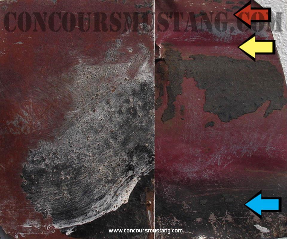

Here are a couple of pictures of sections of floors collected from 70 NJ cars
In this example not much of the body color or pinch weld made it through the clean up process. The blue arrow shows a section with the pinch weld black out remaining. Between the red and yellow arrows you can see some body color overspray as it would have "collected/settled" on one side of the floor rib facing outward towards the rocker. Direction towards where the black pinch weld paint remains.

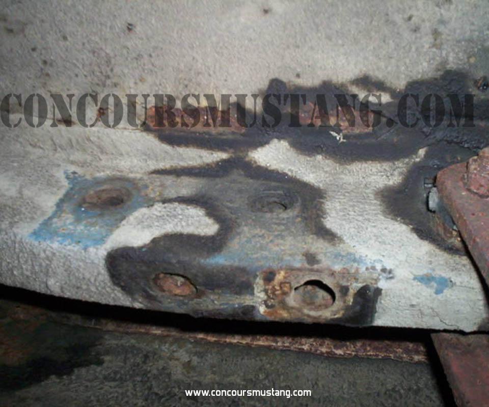

Here is a shot from a 70 NJ Mach. Since the black under the car is often light overspray (unless the jet was close to the panel) if often did not hold up as well as the body color over the years. Possibly the reason the frame rail in the picture shows little or no black remaining

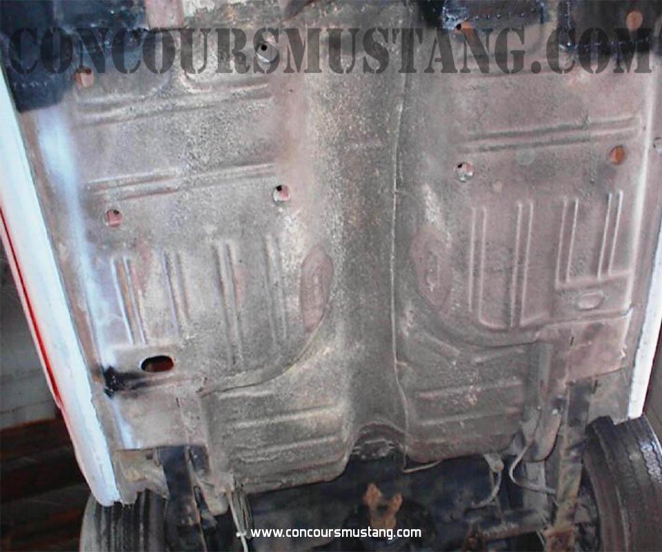

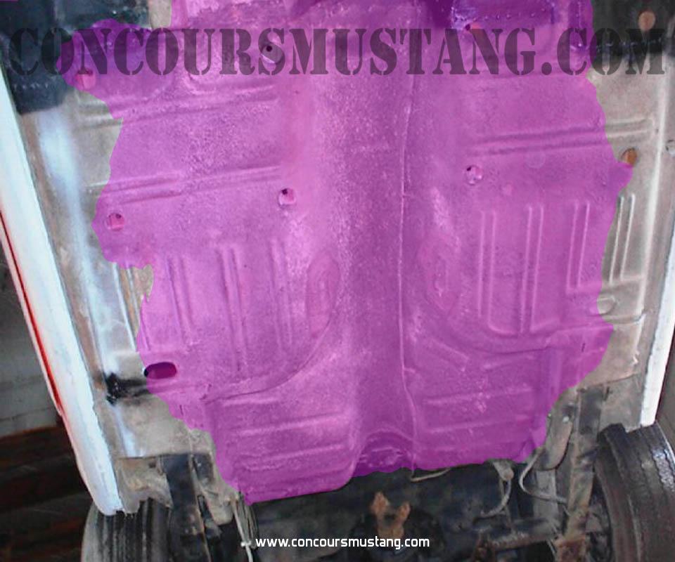

Shot of a 70 NJ with sound deadener followed another picture with the sound deadener area  highlighted
In this picture you can make out the red oxide (to the left) where the sound deadener has been cleaned away, while on the right side still some remaining body color showing through where the sound deadener has fallen off

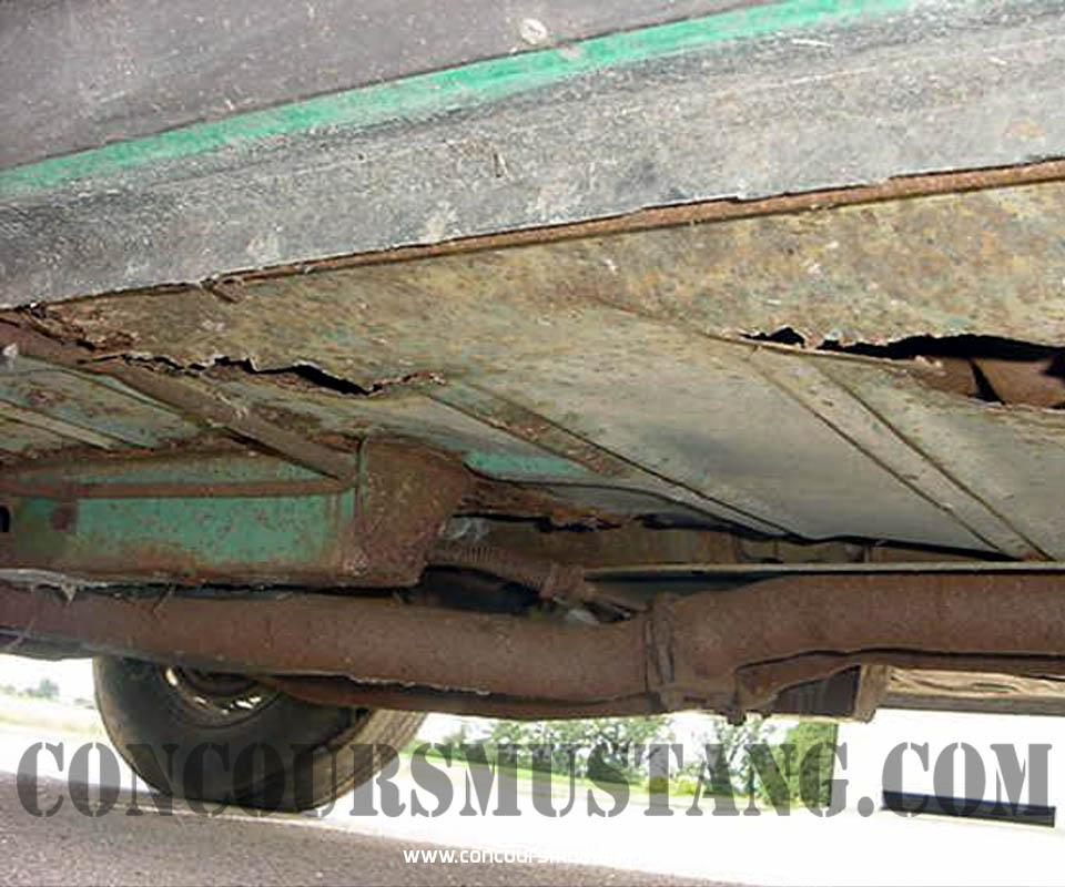

Extra picture showing how on this car even the rear frame rail got a decent coat of body color. And BTW while your doing all this work - don't forget the dolly marks ;)  Don't want to be trying to do them afterwards - in reverse
