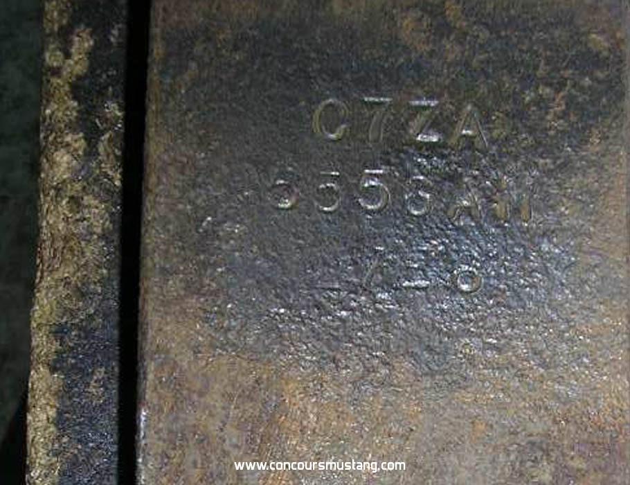

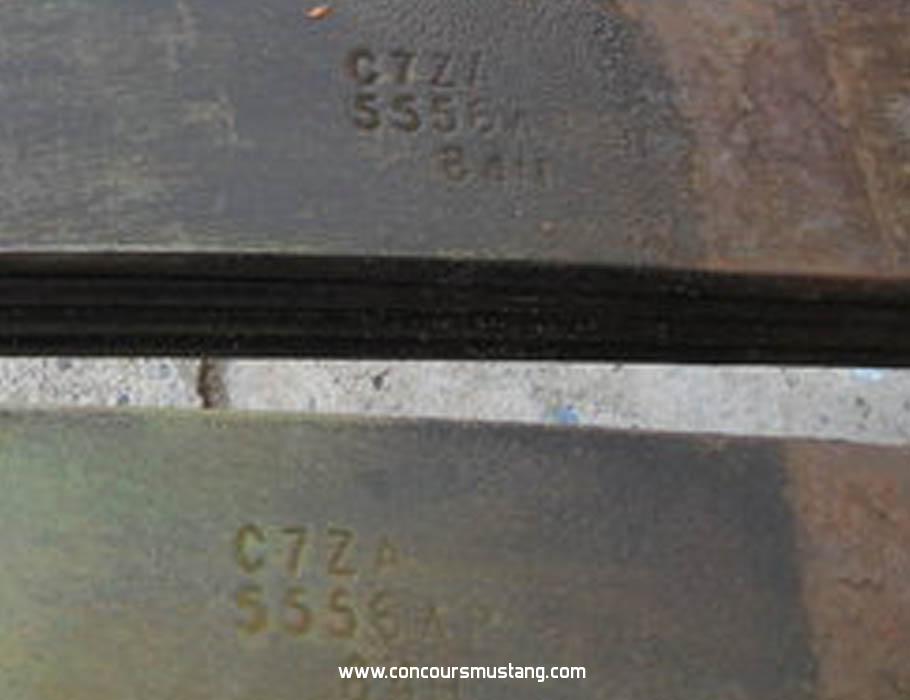

The stamping on the example you show is very different from what I typically see on San Jose springs. Believe its likely a service replacement. Originals normally don't have the Ford oval, stamped so deeply and have the date under the engineering number. Date pattern normally includes letters and numbers.
Can be applied/stamped vertical or horizontal to the spring leaf's length. Shape of the short leaf can also help identify an original or service piece .
One of each of the different stamping orientations
