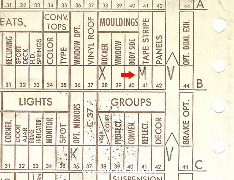

Not sure which buildsheet version you have (they changed during the production year)  stripe color on ones I have was found on line B box 41. Marked "Tape Stripe" The letter appears to identify the type/style of stripe to be installed (Mach, Grande, other models)
Now this only indicates that the side stripe was required but doesn't specify the color in itself. Will look a little deeper - Maybe this is where the suggested color comes into play- standard color except where indicated. Maybe a chart at that installation station
Believe the "Reflect." box is for other applications/car models

     Thanks Jeff.  A copy of my build sheet and it appears that box 41 is empty.  Not a real vital question/answer item so please don't invest a bunch of time on it.  Just curious and though a member might know just off hand.  Brian

     Thanks Jeff.  A copy of my build sheet and it appears that box 41 is empty.  Not a real vital question/answer item so please don't invest a bunch of time on it. ........
Oh you know me well enough to think I would try and run this down as far as currently possible :)
Boy that one is sure faded - can barely make out the V to the right of box 41. Wonder if there was something in the box originally that we just can't see any longer
At the same time, looking at my collection, it appears that I've got a fair amount of "early" Mach's (from Dearborn and NJ) without any markings in the "Tape" box.
Checking the buildsheets (all plants)  last/latest without any markings in the B 41 is from about the end of Oct 68 - Earliest example with a M in the C 41 box is in the middle of December 68
