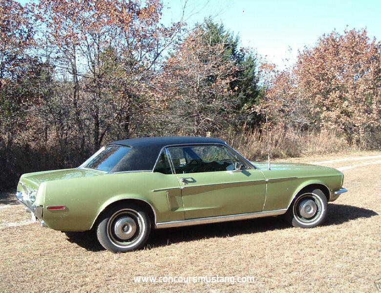

Not sure what this means - if we're correct should not be a big problem. Standard wheel (just like 10's of thousands of others) painted body color
Looks like someone painted the wheels black and only recently that paint has started to wear through showing the body color under
There is also (sorry another coupe) this thread of another 68 Dearborn base wheel and hubcap car

Have seen fastbacks with the painted wheels and small hubcaps - believe most were restored so didn't take any pictures :(

And they are not specifically Mustang hubcaps so when you search look for Ford rather than just Mustang.  No don't think anyone will reproduce these
Hard to say for sure in all of the car photos that were posted, but most look like they may have the running horse logo. That cap is p/n C8ZA-1130-D. The caps with the Ford crest are p/n C8AA-1130-D.
As of this writing there are five loose C8ZAs on ebay, and three full sets of C8AAs + three loose ones.
