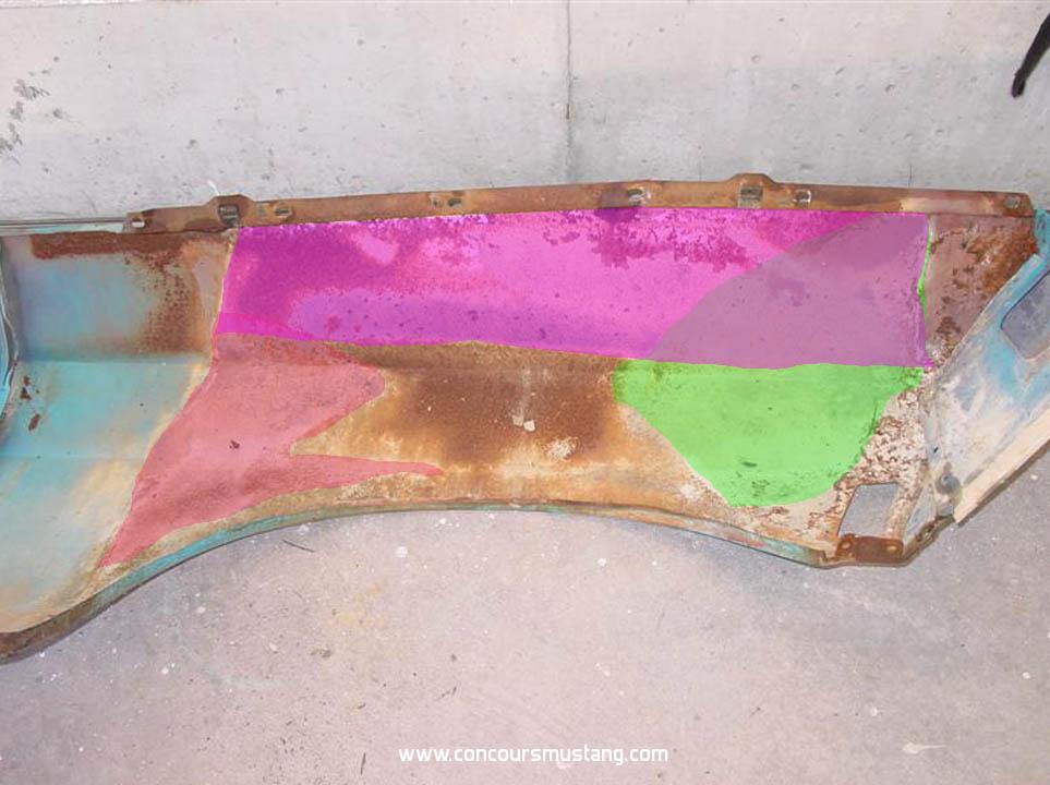

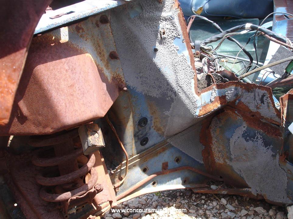

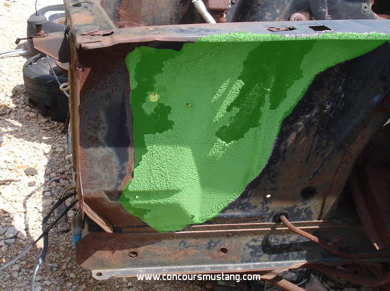

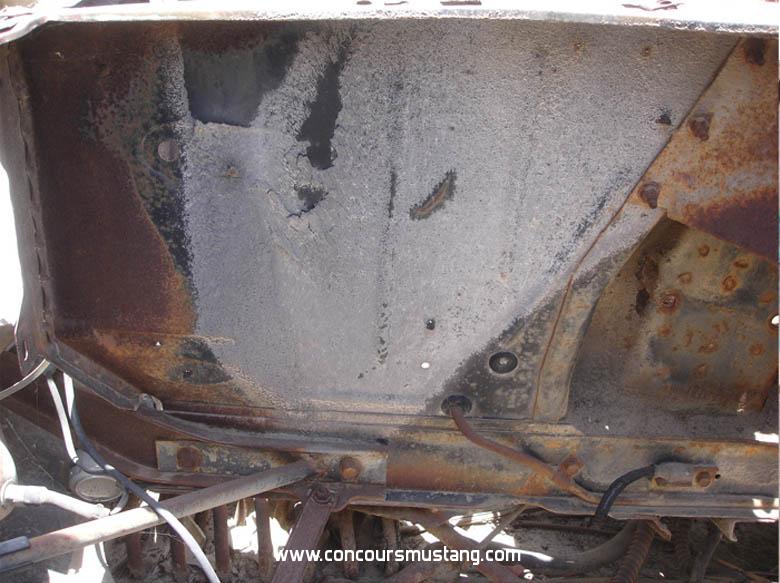

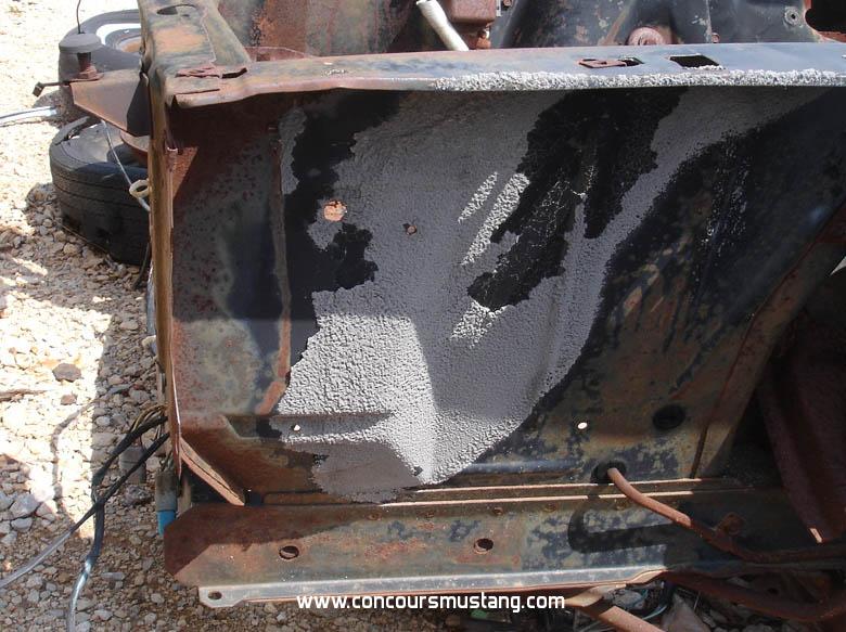

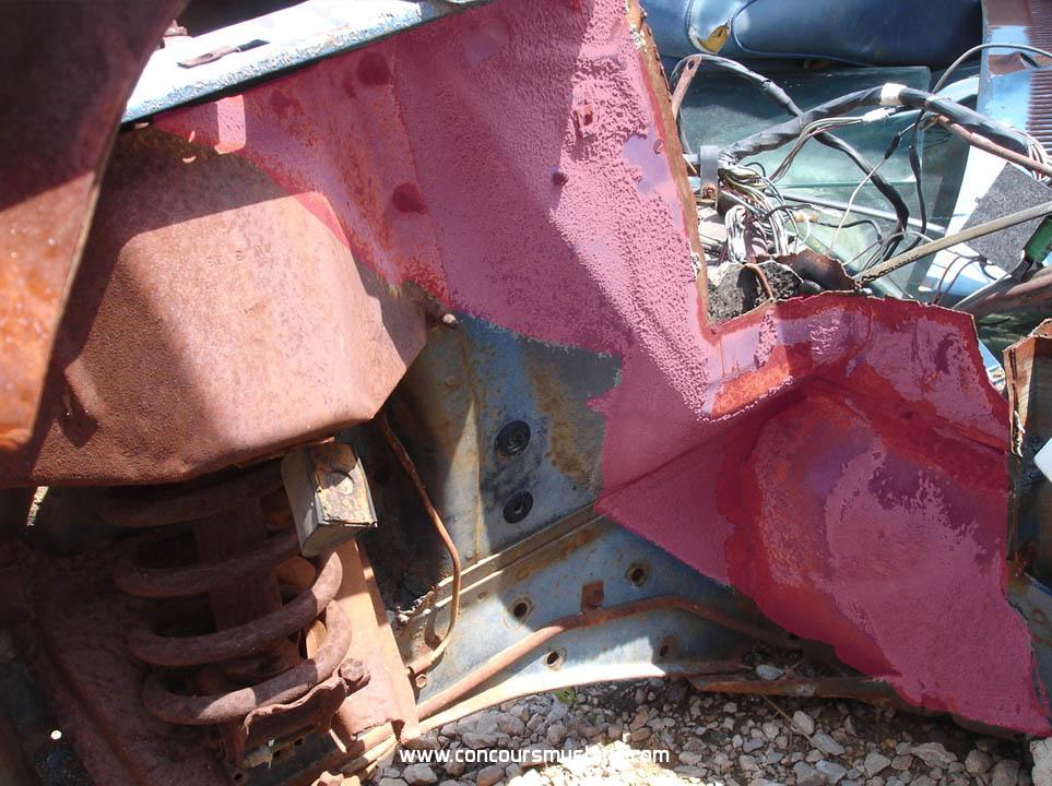

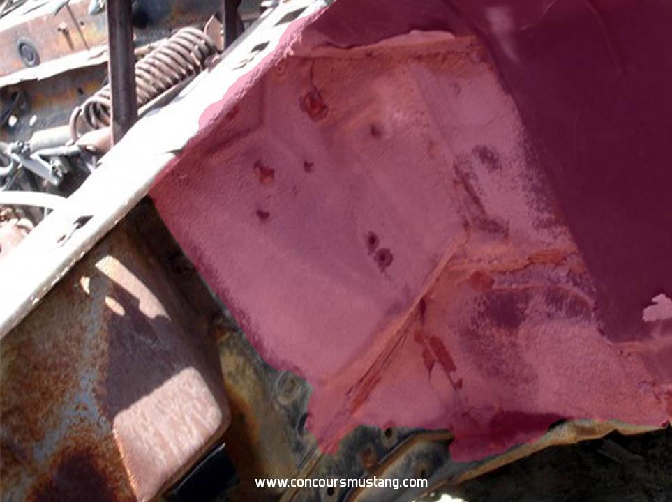

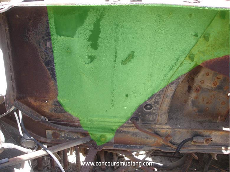

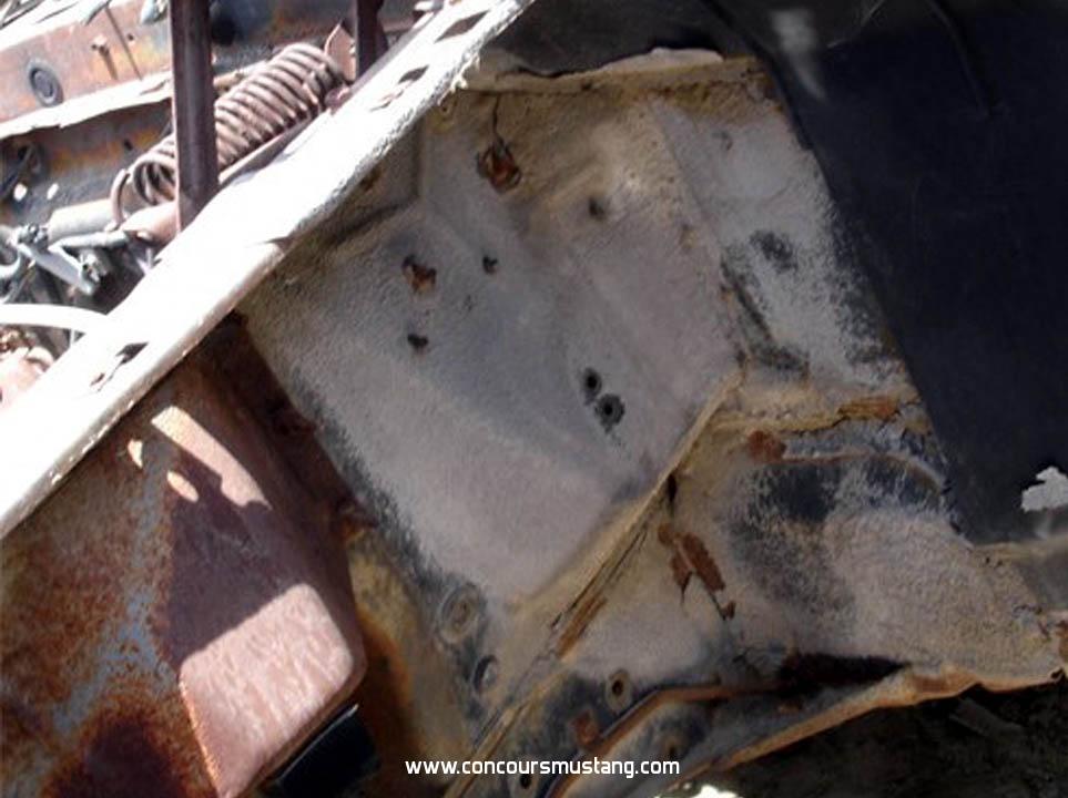

Ok hope this helps and is more on focus this time
Front wheel well sound deadener application for a Fall 69 Dearborn Mustang
I've used to examples from the time period to give a general idea and a little variation
Highlighting was added to show where the worker covered with sound deadener. Worker stood from below the car and sprayed up and inward to apply the material
Section of firewall has been cut away and the splash shields have been removed. They would have been covered during the application
The backside of the front fender sort of ties it all together. You can see where the (highlighted in green) front wheel well application wrapped around the back side of the headlight area, splash shield onto the front fender. The reddish (highlight) pass from the rear section of the wheel well over the splash shields and onto the rear section of the fender.  Then an additional pass over the bottom of the fender with the purple highlighted area. Not easy to explain 3D applications
Hope this helps and is more suited to your needs.

THANK YOU!
This is *exactly* what I was seeking, and your explanation does make sense of the 3-D application. I had no idea the inside surface of the outer fenders were coated to that degree, as I had the impression there was just a quick pass made across the underside of the top surface of the fender. Looks like they used a real wide spray pattern, too.
I'll do my best to duplicate what you've shown, and sincerely appreciate what you're doing to document production details and variances!
Glad we finally got to what you were looking for - again sorry for not getting it the first time
As for the wider pattern - might be the result of just a shorter worker (not as much reach) as some others. Sure it was not one of the prime jobs on the line - but it was a paycheck ;)
