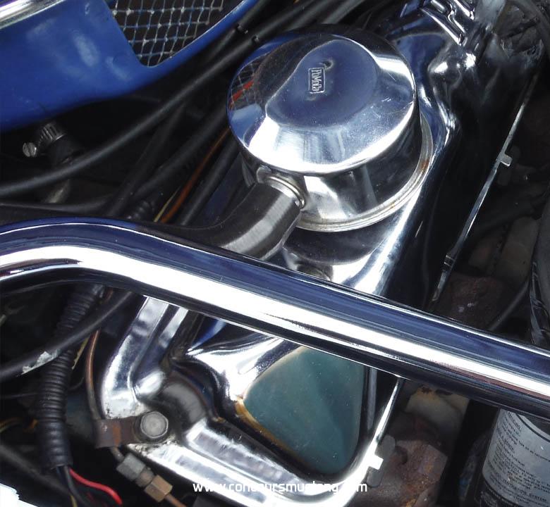

Found another (in my unlabeled pile of pictures)  on an unrestored but slightly played with 7R202xxx fastback I saw last year. Rare comp suspension car.
  • Posts: 9523
Re: 1967 GTA 390 Oil Fill Cap
« Reply #22 on: July 02, 2015, 11:56:34 PM »
The bent style chrome monte carlo bar and the copper mecanicl oil pressure gauge line don't instill a lot of faith in the correctness of the oil filler cap  ;) . I have only seen a twist type opening on BB valve covers . Was there ever a fill neck type valve cover on a BB?
