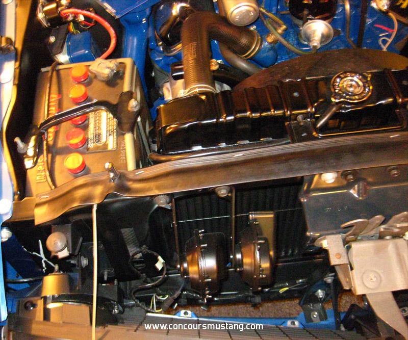

The intent was to staple the seal at the rear edge close of on the forward most line cast into the top rear area of the seal. In that way the forward area would rise up (by form, design and air flow) and make contact with the bottom of the hood. Workers didn't always follow that direction or were very careful on placement of the staples. As always you can use the holes made originally in your original radiator as a guide in these details
Here is an unrestored example from a car finished at Dearborn in Jan 1969 Worker did a pretty nice job on the task this time- Hope this helps

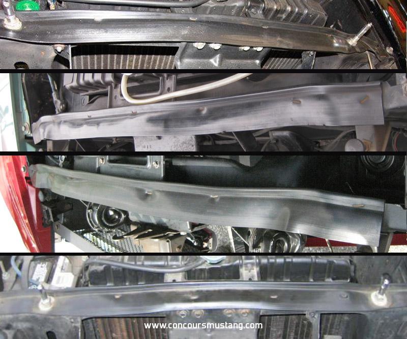

While we are revisiting the subject wanted to post just some examples to show the range and location of staples applied during 69 production at Dearborn

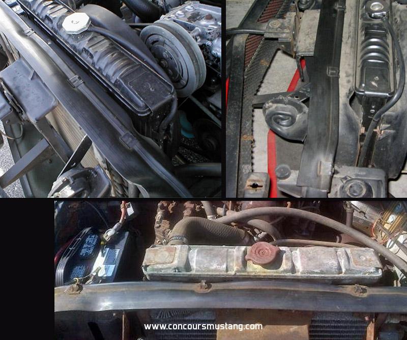

As we have found the stapler did not always preform as expected so at Dearborn, when this took place or when the worker did not put enough staples in the seal electrical clips were used in their place. Just appears that this was their quick fix to keep the line moving. Have dozens of unrestored cars with these. This was not typical or how things were suppose to be but it was not done on only a couple of cars either and there does not seem to be a pattern to the issue so they much have been able to repair the machine fairly quickly and were not without it for a long period of time. IMHO Sharing some examples below
Examples (top left- top right - bottom ) July 69, Dec 68, Feb 69

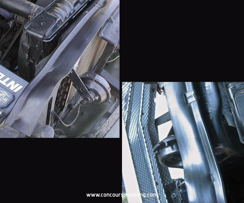

And a few examples where possibly the stapler apparently jambed (or something else happened) mid job or the worker missed the center seal staples and an inspector had clips (since the stapler was at another station) placed in the center to fix the possible issue
