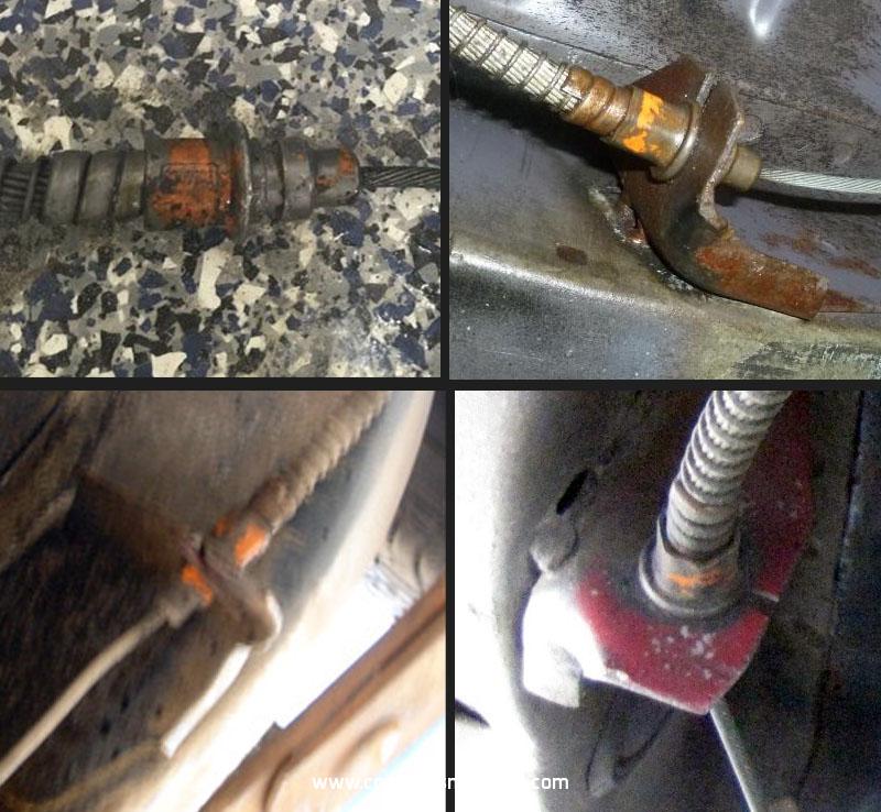

The two original sets I have one from a March 68 San Jose 390 GT, and the other from an April 68 Dearborn CJ both have orange paint daubs on them.
Danny
They may look like paint daubs now but originally the entire fitting was colored orange when new.I have had NOS ones.

Haven't found it to be opaque but instead more of a regular paint. Paint marks IMHO are rarely if ever made with flat paint. More likely than not that is the affect of age and exposure.
Here are four (have more) examples, covering from 68-70, that do show wear and tear from age and use but you can make out the color though originally the coating would have covered more of the surface
Thanks Jeff that is great info a good photos showing where the paint was applied
