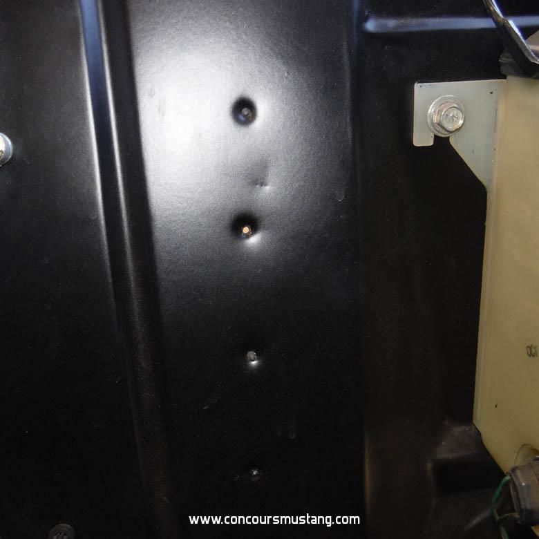

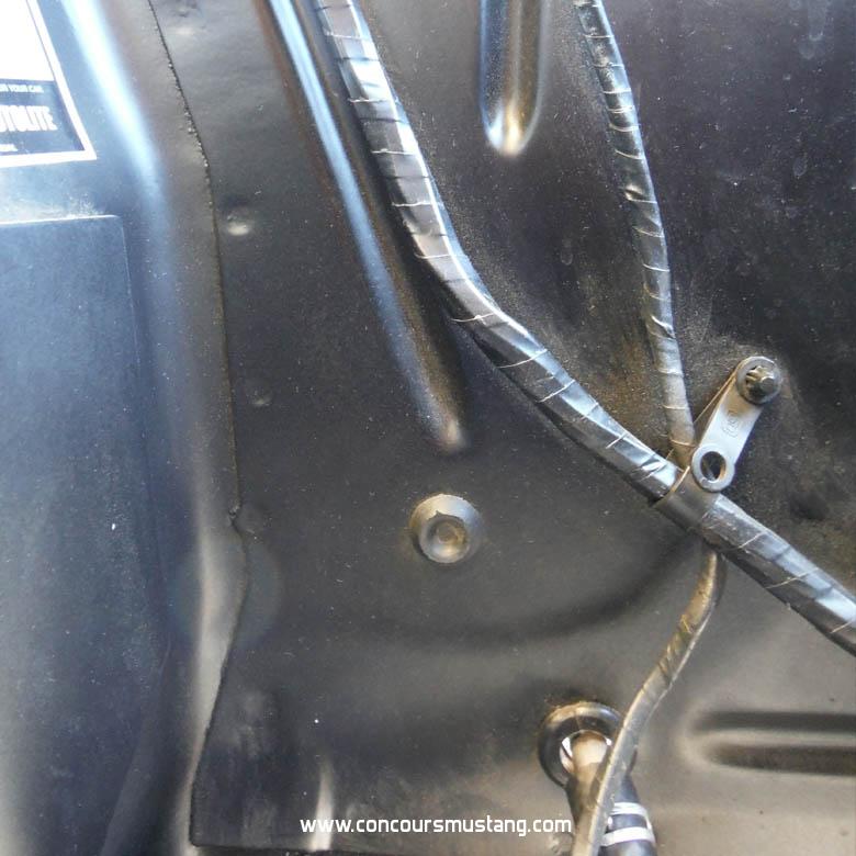

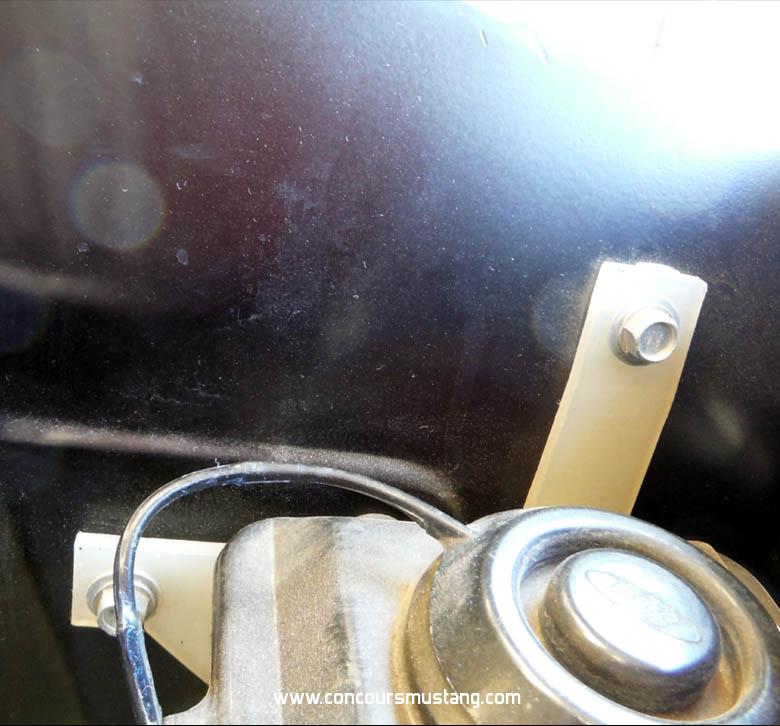

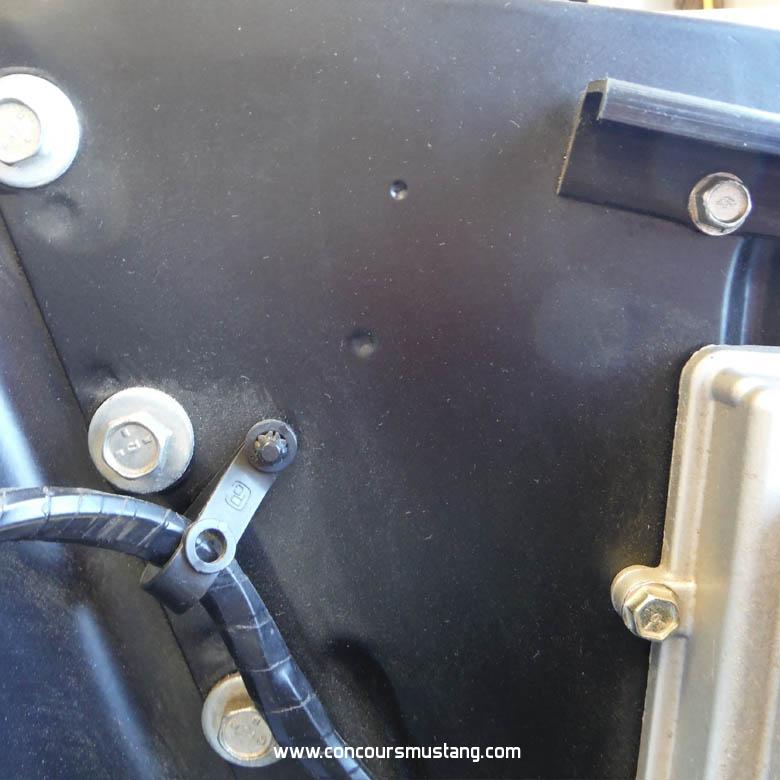

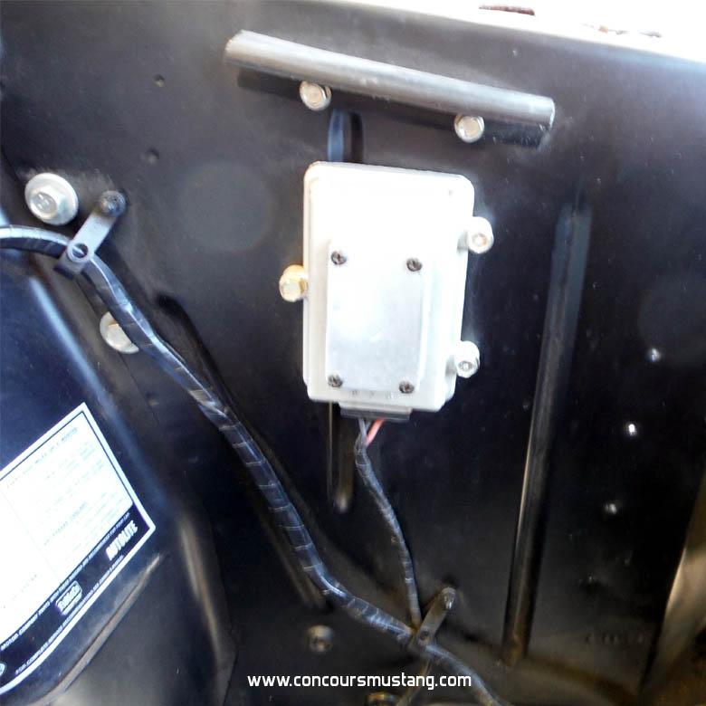

Sorry had to wait for a chance to get to my Boss at the shop.
For your comparison here are a bunch of shots of the drivers side front inner panel. The one that appears to have received allot of extra attention from a PO
Car is from around 9F1883xx
Forward of the rev limiter. Not sure why there are four prepunched (unused) inline holes but believe they are original to the panel (dated 4/21)
