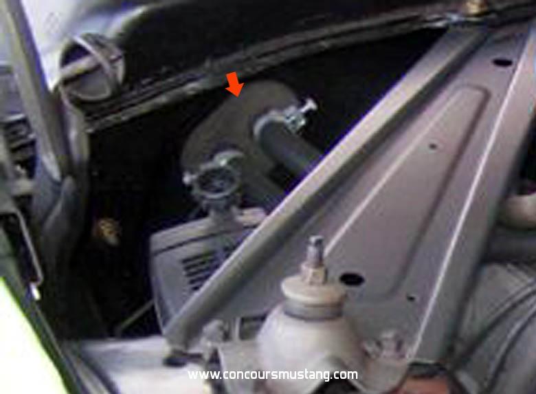

I have a 71 Mach with the 351 Cleveland engine and no A/C  Originally it had a foam seal in the engine compartment at the firewall where the heater hoses connected to the heater core.  The foam got rotten and fell away.  I would like to know where I can find a new one.  I have seen this foam seal on cars like mine at shows, but I can't seem to find where to get one.  The common mustang suppliers don't seem to carry this item.  Any help would be appreciated.

Must be referring to this simple shield sort of seal
May need to make your own after you fashion a cut pattern. Material looks like what is sold in heater seat kits (but thicker) or what is sold as heater core end caps.
Might want to check tool box drawer liners also - sure the bulk material is out there - just have to get creative.
And never make one. If you make a pattern and find a sheet of the material cut a dozen or what ever will fit, keep a couple for spars for yourself, then sell the rest to recoup some of the expense.
And take picture - then you can make a thread (or we can create an article) showing how you did it ;)

Jeff,
Yes, that is the item that I am looking for.  I have seen some really nice ones on restored cars.  I was hoping to find one and not make one.  However, as you said I will probably end up making one.

Maybe they are out there in reproduction form. Looked to the usual suppliers and didn't find any listed either.

Looks a bit smaller than the original examples above - but good try

dkborkstang, I had the same problem.  I found a heater core on eBay with the pad included. The seller was gracious enough to measure the pad and sent me the dimensions.  Here they are:
I tried Classic Auto Air and Vintage AC to see if they may have had either the foam material or the part with no luck.  I ended up locating a foam material that was a very close match to what I had seen in OE seals.  It actually was the foam used in Audio Video equipment cases. The foam that is cut to snuggly fit the equipment to keep it from shifting.
I still have the material and I am sure I can find the dimensions somewhere.  PM me and I will look for all of the info.  I could probably make you one if you would like.

There are two basic type of foam rubber that might be used as a seal, what is called "open cell" and what is called "closed cell". An open cell seal would absorb liquid, oil, water, etc, and would also allow gasses (read fumes) to pass thru (surface like a sponge). A closed cell seal would not (surface smooth, like a radiator hose). So far, all the seals I've seen used on cars were the closed cell type. The picture of the seal from Mac's Auto Parts looks to be open cell, the picture that Jeff posted looks like closed cell. Both types, when new, would be flexible. Just some addition thoughts.
