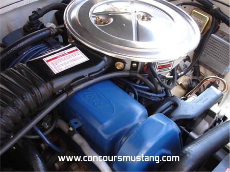

The lid looks like aluminum, but are you sure about the base?
If it is truly completely uncoated, that would be very unusual for Ford. Steel items like this, especially highly visible ones (when the hood was open) were almost always painted, primed or plated to prevent corrosion during shipment or while in inventory.
Weren't assembly line bases and snorkels painted black?
Dave Z.

« Reply #6 on: January 15, 2016, 08:41:31 PM »
Agree bare steel would be odd from a number of standpoints
Apparently just depends on the year and application. Here is an original 78 example of a similar air cleaner

« Reply #7 on: January 18, 2016, 10:39:01 AM »
You have a good point, but on 1979 Mustangs with a 302 they look just like this.
You can see why this is important to keep this looking nice.
