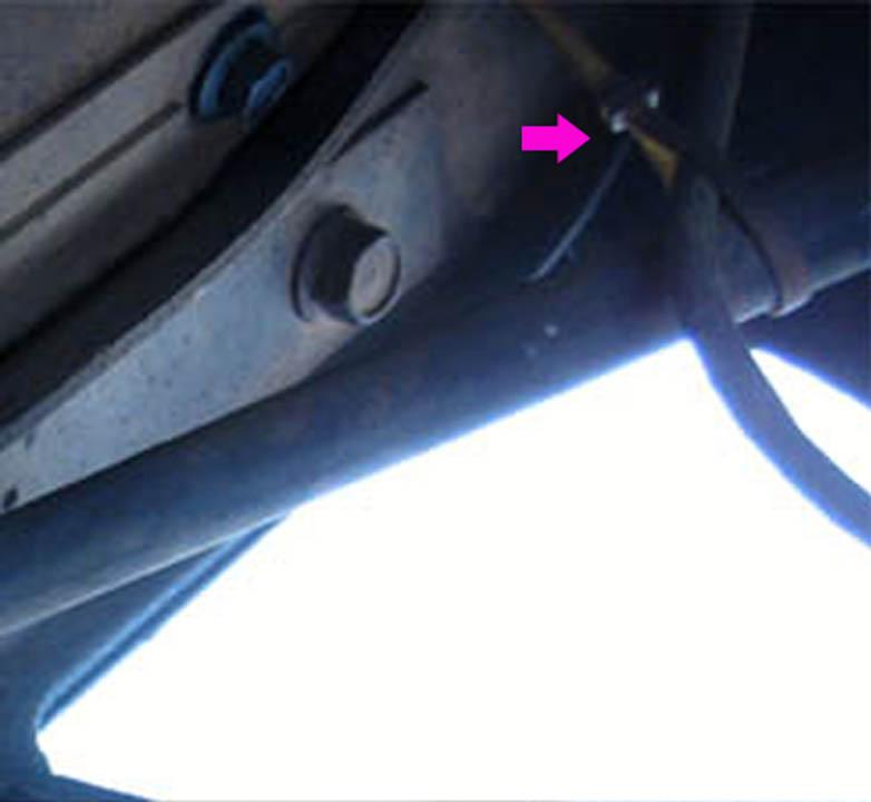

hey guys... My car is a Meutchen build.   do we have new updates on where the side marker light clip goes on these cars?  thx

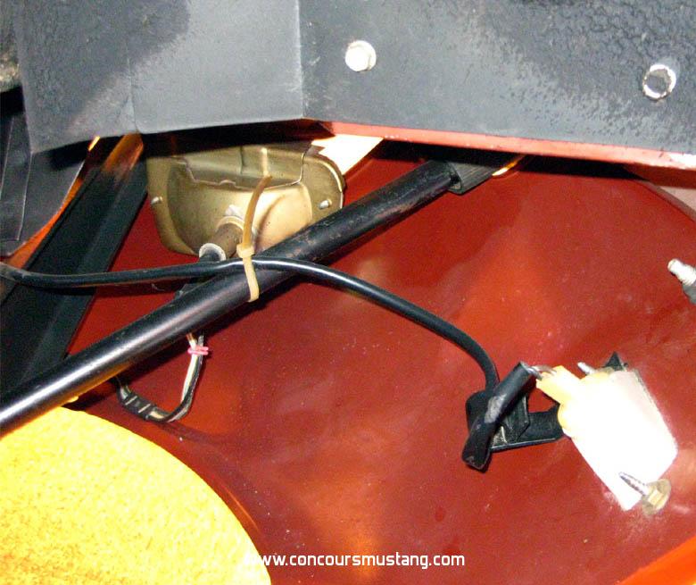

Looks like it's the same at the Dearborn pictures posted along with the nylon zip tie to the tubular front bumper arm. Area where you have it int he picture would normally not be the location and instead be covered with sound deadener as well as the inner fender panels  ;)

thanks Jeff!  Ill move it to the valance panel and zip tie it :)  I put the sound deadener in the Qp wheel wells but didnt know about the front.  I have it on the underside top area of the fender.  where can I find pics of the inner fender panels?

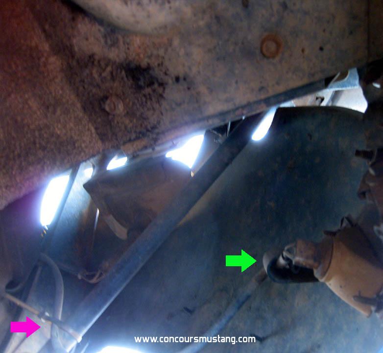

Here is a shot with both the nylon zip tie and the marker light clip. In this case forward stud facing downward. This was taken from a really nice unrestored (original paint) car starting with 9T02M186xxx

I have a photo of an unrestored Metuchen car that also has the forward facing clip like in Jeff's picture.  No zip tie though (could have just been removed).  I think the cable is really too short to use both which is probably why they put the clip on the front of the light instead of to the rear like I think Dearborn did.

So... looking at the last picture posted by Jeff, Metuchen right side, it looks like the clip is attached at the marker light forward post.  Both attached through the valance ?  Correct ?  Thanks,  Brian
Correct - in that picture the clip is attached to the forward post of the marker light. The stud formed in the bezel passes though the valance then the plastic clip is placed over the post and the nut holds the marker light and clip securely to the car.
Jeff - I'm not suggesting there are two different wire looms.  I am pointing out that when you use both the clip and the tye, the wire loom is almost taut, and functionally you could use one OR the other and the wire loom would be well supported and out of the way.  BTW, San Jose used only the tye and works out just fine.
Believe the Dearborn example illustrates (posted again below) that the factory made it work with both with some slack to spare. Did this last week with my Boss and I was able to form a natural looking curve in the wire making all the attachment points. Had to make sure that I went around and below the headlight to main loom junction  as well as over the tubular bumper bracket - picking up a little length. Do agree there is not there is not allot of extra wire to spare.
