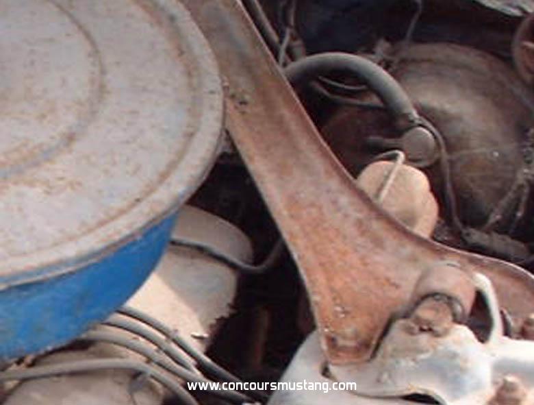

Marty : Thanks for the pictures (I think). I'm a little confused though; most likely because yours has (at least) PB and A/C. It appears that the vacuum line to the transmission comes off of the brass tee on the intake, and, contrary to other comments and diagrams, does not come from the check valve on the booster. This is probably (?) due to the other vacuum sources being needed.  Is the check valve on your booster capped on the port that otherwise would have gone to the transmission ?
Bob
Bob
Yes the port on the booster is capped.  I think our 68 has similar routing. May Jeff has some pictures of some unrestored examples.

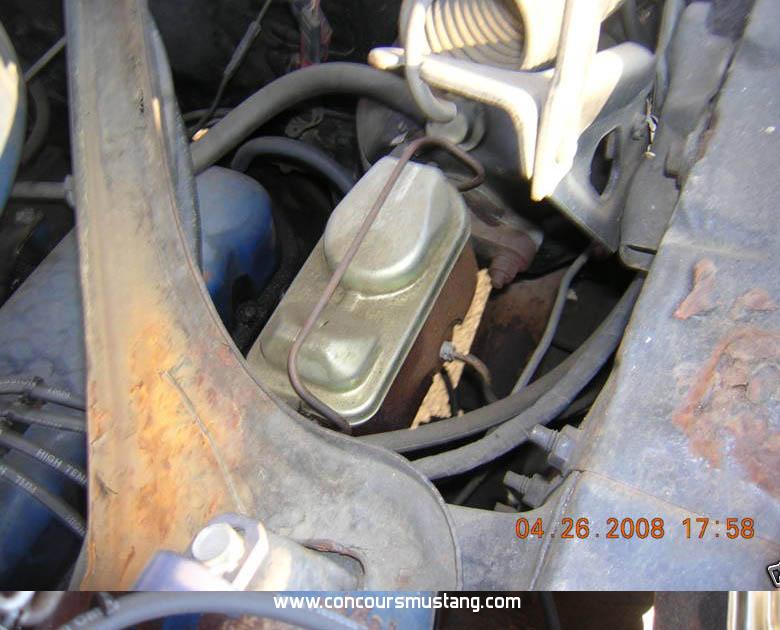

Marty , even though the subject is vacuum hose I thought I would mention something about the picture posted so that there is no confusion. The whole Master/booster assembly -master ,booster ,bail wire and everything in between is painted as a unit semi gloss black .The clamp was typically the zinc silver crimp type for 67/68 . The black oxide pinch clamp on the hose was typically 69/70.

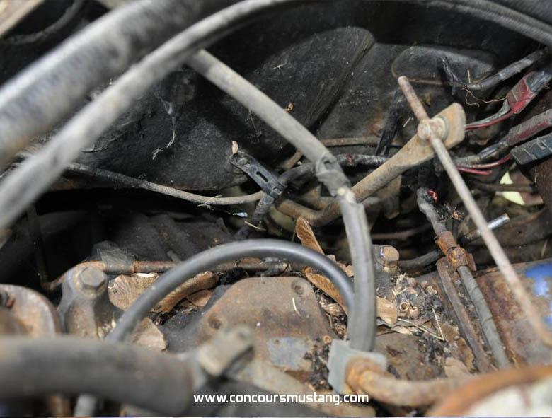

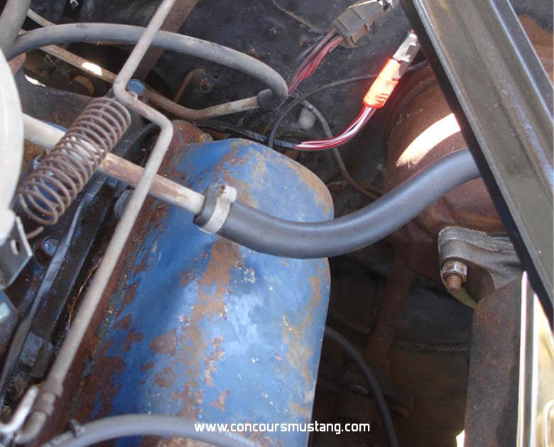

Here are the pics from my car, 289 auto power brakes, thermactor, SJ, Dec 66.  These are from before the restoration started.   Not too long after I got the car on the road in early 1980 I had problems with the trans shifting, and found the vacuum hose from the booster valve to the trans to be brittle, so I replaced it with "by the foot" vacuum hose at a local auto parts store.  So I can't offer that as original, and the length is probably not valid either, considering Bob's request.
The brake booster hose, which I believe to be original, has different clamps than what shows in the picture that Marty posted.  That might be a related topic to chase down.  Also I included a picture of the end of the hose which shows that it is a "corded" type hose.  Sorry for the fuzzy pic there.
As a side, note, looking at the pictures, I do recall also changing the brake MC and cap, and the front shocks.  Bought the front shocks at Sears, and the girl that cashed me out asked what kind of car it was for.  She was impressed.  But I did not ask for a date since the girl I was dating would become my wife.
John, your information is almost exact to mine in regard to the hose location and replacement. I know I changed these hoses out after I bought my example in 1978, they also were brittle. I have no pictures of "before" but I certainly would not have changed the "where" they would have been connected and my modulator hose was always connected to the brake booster until the day my booster failed and I needed to bypass it for a while til it was replaced. After replacing the booster, I reconnected it as it was before, ON THE BOOSTER. I believe this to be 100% accurate and even matches what the body assembly manual looks to be showing.

Has anyone looked at the image of "Installation-Max Vacuum Options Hose Routing-Engine Compartment" (page 7 of Osborn CHASSIS Assembly Manual)
This would be for 67 Mustang/Cougar 289 engines.
Richard : The "image" you refer to is the third picture attached in my "Reply # 3". As I noted (at least I think I did),  this shows, at least to my eyes, the vacuum line going from the Booster Check Valve to the transmission. However, it also shows all of the other vacuum lines for other Options, so my question in regard to that image is, "would it be the same  if you only had one, or two of the Options" ? Of course this still doesn't address my original question as to ID, OD Length and Markings.

Trying to focus solely on 67 Dearborn 289 applications I found the following 4 examples. Only one matches the PB & AT options as outlined in the prior posts.
Think the discussion related to San Jose cars needs to be a separate discussion
So with VIN's and list of options (best I can tell) I offer the following
7F01C1153xx AC PB AT Trans line hooked to booster check valve
7F01C1291xx AC PB AT Tilt Trans line hooked to booster check valve
7F02C1373xx AC PB ATTrans line likely attached to intake rear vacuum block
7F02C2127xx PB ATTrans line likely attached to intake rear vacuum block
